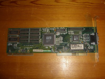

I've just received an ARK1000VL VLB video card. The BIOS chip is dated 1994-5. The one on this webpage by Vogon's user Vlask is dated 1995. You can see a better image of the card, by clicking on that first photo on that webpage. The FCC ID on the card I have is LBG-1000VL2M, and its P/N is EMA0041000B0. I wonder if this is a Hercules Stingray card? If not, who made it?
I found a download on DriverGuide for the Windows 95 driver and tools. For your convenience, it can be downloaded from the VogonsDrivers website, here. Please note that I haven't tested it yet. The filename is called arkw95vl.zip, and the readme.txt says:
ARK Logic Windows 95 Display Driver Version 1.29
ARK Logic Windows 95 Display Tools Version 1.08
Question: I would really like to download a DOS/Win3.x driver package for this thing, please. I can't find anything on the net. Is anyone willing to do an upload, please? Thanks a lot if possible! 😀

I have two of these cards. I think both of mine are supposed to be from 2theMax. However...
It appears to me that ARK logic was actually the one that produced the board, and supplied it to several different companies. 2TheMax, Hercules (Stingray Pro) and Paradise (Bali 32) are all identical except for the contents of the BIOS. Unfortunately this means if you have a 2theMax card the Hercules drivers aren't going to work. I suspect the driver just checks the header of the card BIOS. I remember trying this a few years back and got nowhere (this was for windows 3.1).
I think in the end I managed to find a generic driver, but I would have no idea where the hell it is at the moment.
The only ARK1000 cards I have ever seen that don't use this PCB are the ones from Octek (ocean technologies). I believe they released 3 different cards using the ARK1000 chipset. Two of them just use different memory packages, and one integrates multi I/O.
From what I can remember, the drivers are pretty barren of features but seems to work. It's a pretty fast card in DOS, but you benefit greatly from using VBE (much better compatibility).

I also have the same card as pictured in the 1st post and also can't find working drivers for it.
BIOS string is only:
ARK Logic GUI Accelerator BIOS Preliminary Version 1.20 - 0217 Ref 00
Already tried the Hercules and Spea ones but they have some checking routine and won't load 🙁
Any workaround or real drivers from somewhere?

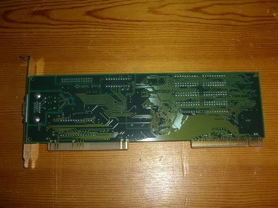

Reply 18 of 29, by Skyscraper
This is my ARK1000VL VLB, it's more or less identical to member retro games 100s card but my card has no soldered memory.
I will test the drivers some time in the future, my VLB project got stalled as I got sidetracked.

Reply 19 of 29, by kixs
elianda wrote:
Not sure what these drivers are. Can get them to work/install under Win 3.1 - maybe for NT. I tried installing ARK2000 drivers and they install OK. Even look right, but there are glitches.
Finally found the drivers that work:
http://driverzone.com/drivers/paradise/bali32/
Visit my AmiBay items for sale (updated: 2025-07-28). I also take requests 😉
