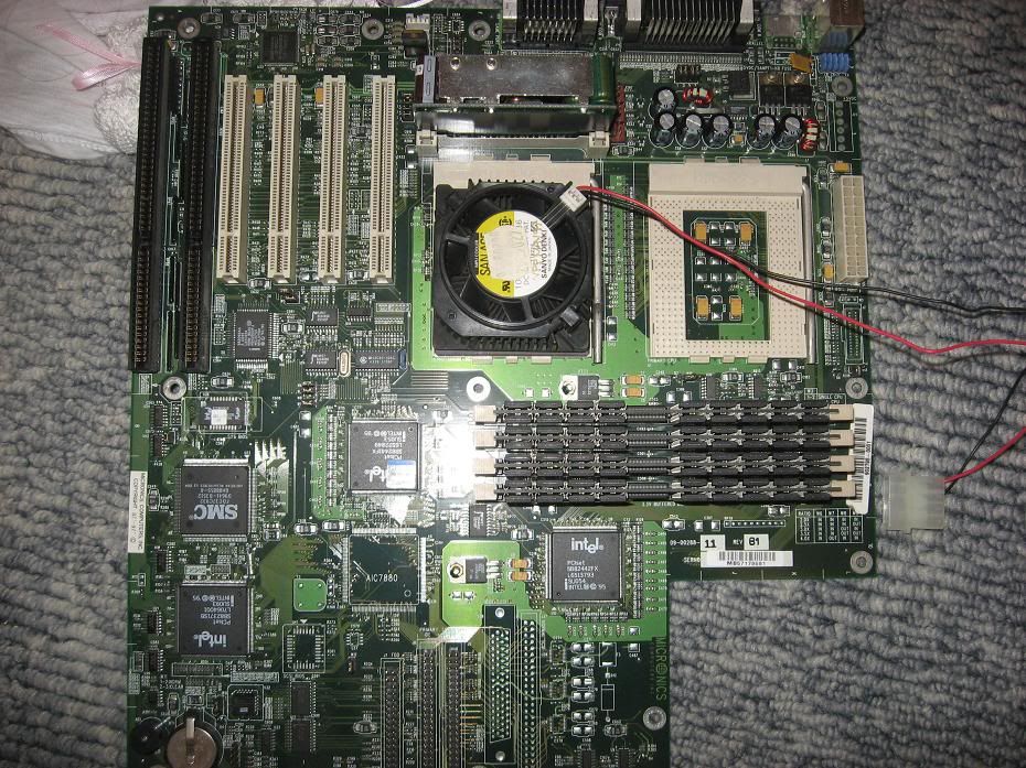

MICRONICS W6-LI - Dual Pentium PRO (Socket 😎
http://stason.org/TULARC/pc/motherboards/M/MI … -Pro-W6-LI.html
Dual pentium pro motherboard, ATX! This came with a very handy and maxed out 512meg of ram
Pentium 2 overdrive 333mhz, the very last overdrive intel produced, nice performance increase over the Pentium pro 200 with 512 full speed cache & mmx.

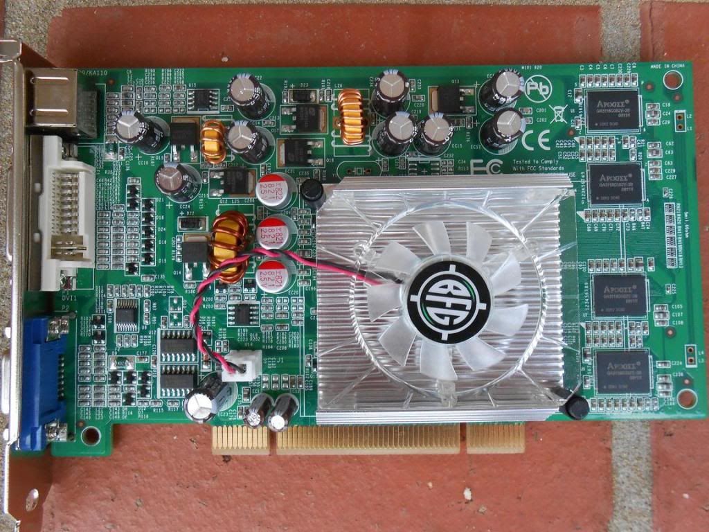

BFG 6200 OC PCI 256meg, this card is the fasted thing in PCI format if you want to run windows 98, it also has DVI for crystal clear images on a modern LCD, a quick slew of benchmarks in dos showed no funny imperfections.

Reply 1 of 30, by F2bnp
Oh man, I want one of those babies, but motherboards are hard to find and very expensive (especially for dual cpu setups!).
Awesome man 😁
Reply 2 of 30, by GL1zdA
The Overdrive 333 is basically a Pentium II Xeon in Socket 8 form. I always wanted one, but I have seen only offers with the heatsink removed, which is non-standard and would require some work to recreate.

after about 300mhz the 66mhz fsb really starts to be the limiting factor. especially when you have 2 processors.

Has anyone seen a socket 8 to 370 adapter? Haven't seen one in many years but allowed socket 8 boards to use socket 370 66mhz fsb celerons. http://img.tomshardware.com/us/2004/12/20/the … pentium_pro.jpg
Reply 12 of 30, by Old Thrashbarg
I've heard of 'em before, there were a few different variants of them made but AFAIK they weren't that widely available outside Asia. But the primary problem with 'em is, they weren't particularly useful... since Socket 8 boards generally wouldn't know what the hell to do with a Celeron if you installed one. Even the Powerleap adapter, which was the most advanced of the lot, had problems getting the Celeron's L2 cache to work on a lot of boards.
