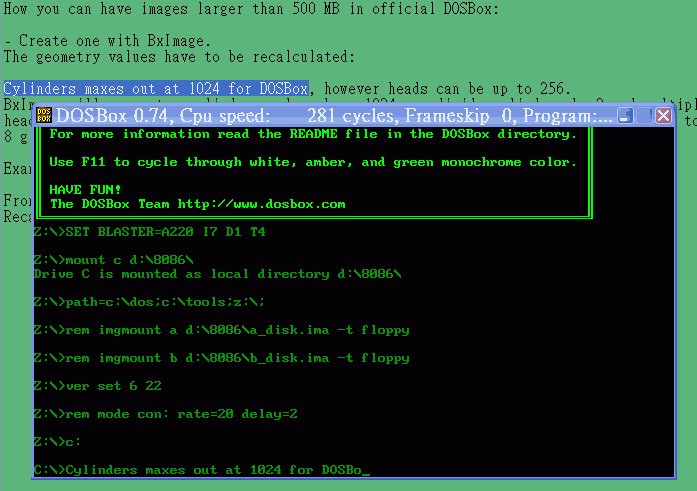

Reply 4 of 16, by coolhaken
This is a useful program for me. Thanks.
But there is a problem. It losts characters ...
    7.45 KiB
    289 downloads
    Some characters lost
Reply 5 of 16, by emendelson
But there is a problem. It loses characters ...
Try pressing Ctrl-F12 to speed up DOSBox and see if that helps. Also, tell me which of the two utilities you are using (background or non-background version), and I will post a version with a slight delay between each emulated keystroke. That may solve the problem.
Reply 6 of 16, by coolhaken
I cancel the "mode con: ....." command and try background and non-background version.
Now they lost the last character. Two versions have the same problem.
Speed up DOSBox doesn't help.

Reply 8 of 16, by emendelson
I figured out that when I fixed my code to accommodate upper-ASCII characters, it started dropping the last character of the clipboard. The current versions fix that problem, and introduce slight delays that may prevent other characters being dropped. Please let me know if this fixes the problem.
Reply 9 of 16, by coolhaken
The newest version solves the problem of lost last character.
