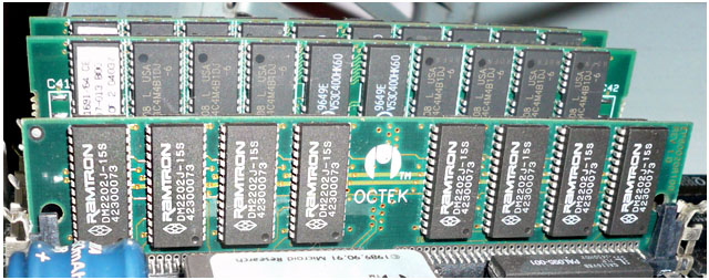

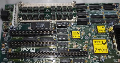

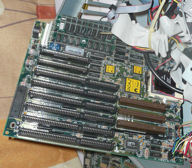

This is the mobo that I had been using throughout the 486 era. IIRC, the "Dynamic Cache Architecture" were implemented in different levels. The full implementation was significantly expensive due to the need of a proprietary type of EDRAM memory. Motherboards with this full design were labeled "DCA2" and were reasonably fast but pricy and rare. In fact, what was well-sold in the market was a budget version without the ability to take the advantage of EDRAM memory but merely with the extra-wide memory bus. It was labeled "DCA1" or simply "DCA". IMO, these "perfect" labels were subtle enough to make Octek the winner in many benchmarks by testing its cutting-edge DCA2 unit and then leveraged Octek's market share by mass selling the compromised DCA/DCA1 units. For an ordinary user, he/she might not necessarily be aware of the substantial difference among DCA2 and DCA1/DCA.
Despite, I had a pretty positive impression on the DCA2 mobo. In my ad-hoc stress test across different 486DX mobos, the DCA2's overall performance was outstanding in dealing with those heavy-duty CAD and 3DS tasks. But I didn't do any gaming test or compatibility test. In the other hand, the DCA1's performance was below the most of 256k cache-ed 486DX mobos and was equivalent to those cache-less 486DX mobos. Attached are pictures of my DCA2 mobo and its EDRAM. It is currently in my parent's apartment which is located on the other side of the earth from my home 😀. I might have access to it after a few months and I'm expecting do some benchmark PK aginst my other socket 3 mobos including PVI-SP3 and FIC-PIO3.
This is my 1st post in this forum and my apologize for my poor English.
[/img]
    168.12 KiB
    3243 views
    Hippo DCA2 Motherboard
    90.6 KiB
    3243 views
    Octek proprietary 15ns 72-pin EDRAM (the 1st SIMM)

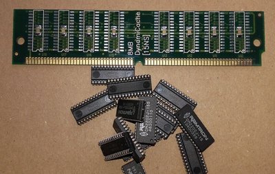

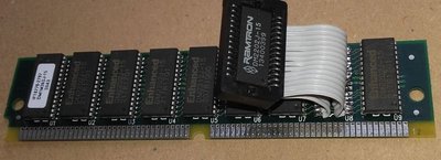

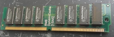

Reply 13 of 15, by BastlerMike
I finally managed to get my hands on a functional DCA2 board. Years ago I already found one (with two 8 MB DynamiCache modules) but it was heavily corroded and not revivable.
196.58 KiB
1406 views
Now, it unfortunataly turned out that one of the memory modules was not recognized by the motherboard. I supposed at least one memory IC being defective. As pointed out by "dca2" one source of EDRAM chips are these DEC KZPAC resp. Mylex DAC960 RAID controllers. I sourced one of them equipped with a 4 MB EDRAM SIMM cheap on ebay. These SIMMS are also working with the DCA2 motherboard.
A lot of soldering work was necessary to figure out, which and how many memory chips on the Octek 8 MB SIMM were non-functional:
120.64 KiB
1406 views
all memory ICs desoldered from Octek 8 MB SIMM
60.35 KiB
1406 views
single chip test socket soldered on 4 MB SIMM
One fried memory IC was identified and replaced and all was again soldered together.
62.02 KiB
1406 views
Speed tests and benchmarks will follow...

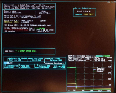

Reply 14 of 15, by BastlerMike

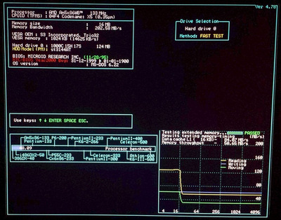

After long time I made some tests with the DCA2 hardware. Configuration isn't easy, because the documentation is pretty poor.
No way to switch the Am5x86 chip and other WB enhanced chips to writeback mode.
Speedsys says 5x86WB cpu, suggesting activated wb mode, but L1 throughput shows that it isn't.
Even with the corresponding pins directly bridged on the CPU, the system will not start.
Pentium Overdrive chip seems to work excellent with L1 WB activated. Cx5x86 does not work at all, the system locks up immediately.
    109.6 KiB
    617 views
    PODP-83
    182.73 KiB
    673 views
    Am5x86-133
