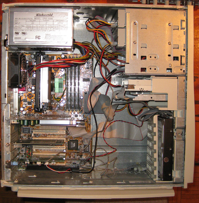

Well few months ago I got a "working P3 500" for £5
I guess it worked in as much as it turned on but once I got it home found it had no ram or video card, slightly upset as I couldn't play with it straight away but really I'd probably upgrade these parts anyway.
I wanted to stick with a slot1 setup as I like how the cartridge includes the heat sink/fan, there are no pins to damage it just seems more organised then sockets, but I also wanted the fastest so upgraded the 500MHz CPU for a 1GHz.
However I stuck with the 100 FSB CPU as I also wanted to use the legendary BX motherboard. I know some BX boards can be jumpered to 133 FSB but that's not really where my interest is.
The original idea was to use this while in the UK then when I return to Australia take a few parts back home and set up again using a ASUS P2B ZX which was the family's old PC and 90% sure is sitting in the garage so got 2 sticks of 256MB of PC133 RAM as that's the max that board can take, and I can push that board harder if I decide to.
I also got what is supposed to be a 32MB Creative TNT 2 Ultra as long term this was going to be used in my stupid quick dos PC and that's the last card to support Win3.x
I say supposed to be as it says it's a CT5823 but it's passively cooled? Either way I paid next to nothing for it and nothing in dos is going to notice the difference.
Next I put in my matching 12MB Diamond Voodoo2 cards and made a SLI cable, which worked 1st time!
I am still new to the world of Voodoo cards so still checking out the games I played in D3D first time round, so was quite excited to have a SLI setup up and running now!
Next was the Audigy 2 ZS so I can get EAX support and on board audio is always crap
Finally I had 2 Maxtor Fireball 3 40GB lying around so both of those went in, and left the Generic CD-ROM it came with.
Installed Win98 and that's when I was quite pleasantly surprised!
I wanted to use my SC55 with the PC but as I don't have the Audigy's Midi bracket went to install the on board audio drivers only to find it listed as a Yamaha XG 64 Voice Wavetable. That got me very interested!
Indeed Midi devices shows as a Yamaha XG Midi device and doom sounded surprisingly good! Plus the left & right channels are reversed just like a real SB Pro!!!
As I'm not into overclocking the fact it's a real Intel SE440BX board which are as stable as they come makes it very attractive. Intel SE440BX3 to be exact. The only problem is Dell nonstandard ATX connection, but adaptors are still quite easy to get.
This now leaves me with a problem though as I quite like this board, it's fast enough for all my Glide games (mainly NFS3-5 Diablo's) but has also made my 486 redundant as it has no issues with my dos games. (Mostly mid 90's or later) and if that's the case I'll probably put in a better AGP card then the TNT2.
Here a pic I quickly took, still needs a bit more of a tidy up, the live drive is for another project but put in as its safer there then just kicking about in my room!
and the inside
Edit, updated link to picture

Reply 2 of 36, by Mau1wurf1977
Nice build! If the PSU is ATX and doesn't have some proprietary pinout then you could also swap that out.
BX440 machines are indeed very stable and a joy to work with. Wondering if you can get that Yamaha chip working under MS-DOS mode.

Reply 4 of 36, by chinny22
yeh it’s a proprietary pinout but I'll get a converter cable in the near future, They aren’t expensive and I can then get a nice modern quiet PSU once back in Oz.
I downloaded the real dos mode drivers the same time as I got the Win98 drivers, just haven’t checked them out yet. I’ll let you know!
I always make a point to set a machine up to play from dos, even my P4 with another Audigy 2 ZS can join in a pure dos game of Doom or C&C.
I did a bit of research and settled on the 2 ZS, can’t remember why I didn’t go for the Audigy 4 in the end, maybe just because it didn’t really offer much more and they are harder to get.
What’s this about them overheating though?

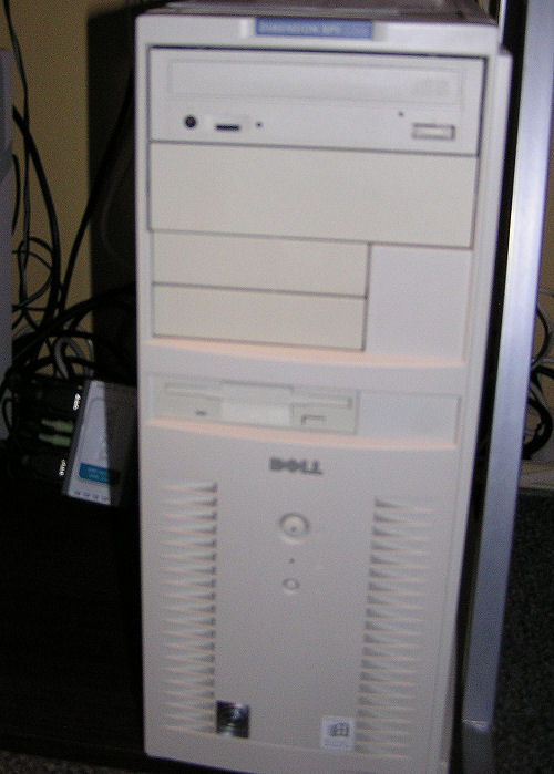

Reply 9 of 36, by feipoa
I have that same Dell case. The 1998-1999 era Dell cases have always looked good to me. I had a Celeron 400 in that case, which I've since replaced the motherboard with a s370 and turned it into my VIA C3-1200 Nehemiah box. The only thing I didn't really care for is how the hard drive is normally mounted verticle, but I see you've mounted them in the 3.5" floppy bays.
You have what looks to be the original CD-ROM drive, at least that is what my Dell came with in 1998. They really did a good job back then of matching the CD-ROM drives to the cases.
Here's an image of my case and how the HD is normally mounted. This is back when it still had a 1 GHz slot 1. I only have 2 DVD-ROM drives installed because I don't have the original 5.25" slot cover. I rescued this case sometime within the past 2 years - I did not buy it new. Do you still have the original 5.25" slot covers?

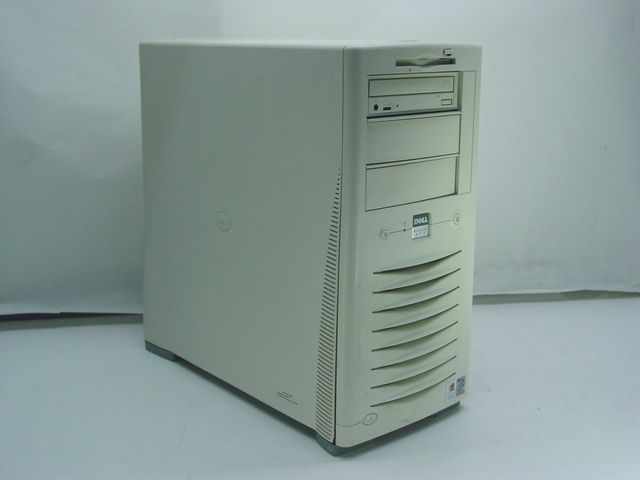

Reply 12 of 36, by feipoa
coppercitymt wrote:
Proprietary or not I am partial to dells too, I like the older ribbed style case's.
I remember that case. In my opinion, it is the best looking Dell mid-sized tower for home use. My favourite workstation case is by far the Dell Precision Workstation 410.
Anybody who has used the 410 case will understand - push the button shown on the bottom left of th image and the side L-panel flips off off, push a button under the L- and the front panel comes off, the 4/5-bay HDD bay slides right out with a handle, the power supply can be rotated 120 degrees out of the way on a hinge (while still being connected), and the 5.25" bays are simple slide-in-to-connects. It was pretty revolutionary for 1998 and it was clear to me when I bought it that Dell spent a lot of money on ID.
While I've already posted this photo in another thread, it really belongs here. I'm using an internet sourced photo because my photos just don't do it justice.
One comment on proprietary cases; they can be modified. That Dell Dimension shown earlier was altered to accept a non-Dell motherboard and PSU.
Reply 13 of 36, by chinny22
I got the fans to cool the v2 when it was in a P4, Only put them in this as they had nowhere else to go. The fan mounted on the side sits pretty close to the cover when it’s on so don’t think it really does much, its more just to encourage air movement round the V2’s but if its helping the Audigy then great, although I’ve been playing with the Yamaha more for the time being.
Didn’t get any 5.25 covers, It came with 2 CD-ROMS This one works most the time but the other which was pretty similar to feipoa’s DVD was completely dead. I stripped the insides including the tray and was going to mount a IDE CF reader in it, rekon it’s a good idea but doubt I’ll actually ever do it.
Ahh now I get how the HDD thing works! The pdf I found online wasn’t very clear, I thought I was missing bits. But yeh that’s crap I’ll leave the drives where they are I think. Not sure how the floppy bay works either? I don’t have the original drive but just ran a strip of tape from the side of the FDD onto the plastic bit, seems to work 😒
Not the biggest fan of the case, The ribbed Dell looks nice but 3 3.5 bays!?
I rekon the Gateway GP6 I had back in the day looks better, inside it was useless though. This case is well thought out I’ll give them that.
