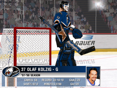

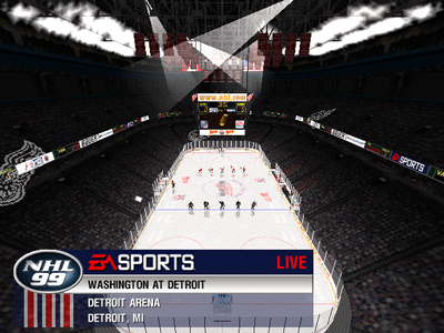

Gamecollector wrote on 2021-12-31, 22:54:
Verite is forced to d3d, Rage isn't affected (this game can use the CIF API).
I have tested Ati 3D CIF and looks OK.
606.29 KiB
3912 views
NHL99 ATI 3D CIF
624.2 KiB
3912 views
NHL99 ATI 3D CIF
It uses ati3dcif.dll because if I rename/remove it, the game falls back to software mode (but if I move the D3D files, the game still in 3D).

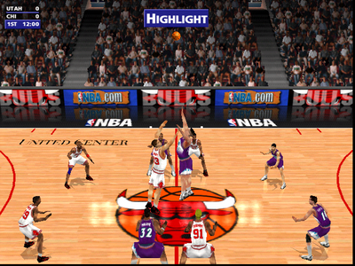

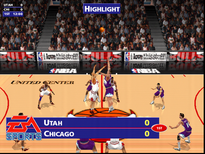

I have tested NBA Live 99 on Rage Pro with ATI 3D CIF (I have deleted the D3D switches in 3ddata.dat than I have run 3Dsetup).
It starts with ATI 3D CIF but have bugs some black is missing (hair, shoes, knee pads) and parquet looks bad:
639.56 KiB
3771 views
ATI 3D CIF
658.6 KiB
3771 views
Direct 3D
