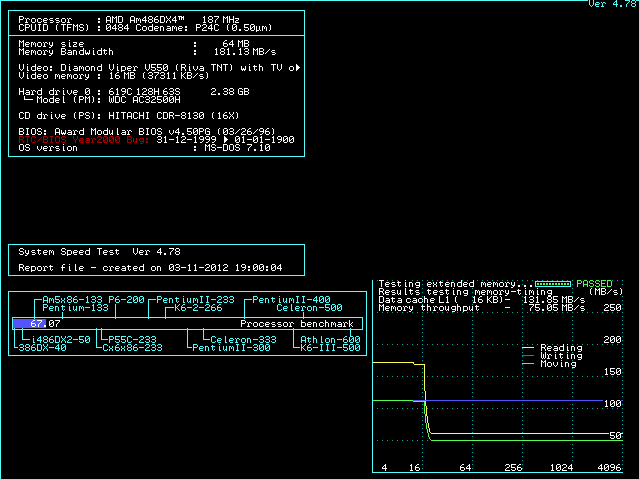

Well my 8433UUD board is dead (RTC), so I swapped it's BIOS with the M919. MUCH better BIOS! (I forget how awesome it was).
So as of now I'm using the M919 w/ the 8433 AWARD BIOS, not the AMI. It's actually quite stable and feels faster... preliminary benchies!
AM5x86 @ 60Mhz bus, 3x multi, ~187Mhz, L2 cache disabled (purposely), 64MB EDO @ 0/0WS, system is surprizingly stable (as of now)
Speedsys 4.78 score: 67.07
Memory Bandwidth: 181.14 MB/sec
L1 cache: 131.85 MB/sec
Memory Throughput: 75.05 MB/sec
3Dbench: 100.0fps
Quake timedemo2 = 19.0fps

Reply 18 of 27, by feipoa
You'd be better off replacing the RTC in your Biostar MB-8433UUD board. It is not difficult and the new RTC will last 15+ years. Using the wrong BIOS in another motherboard often appears OK at first glance, but funny issues start creeping in on you.
To establish stability in any 486 system, I like to go through the rounds of installing Win98SE w/IE6 and the unofficial service pack using a SCSI or other PCI bus mastering hard disk controller card. Run at least 3DMark99Max, 3DWinbench97, and Quake2 in software mode. If that is successful, install WinNT 4.0 on another partition using NT's default boot loader. Install all service updates, including IE6. Run Winbench96/99 and WinTune98. Play an mp3 for 2 hours continually. If that goes well, try for a Windows 2000 installation using the defaut boot loader again. Same drill of tests. You can also try CPUburn or CPUstab. Stay away from the onboard IDE controller because PIO mode really bogs the system down.
My MB-8433UUD will pass all this abuse and this system has been on 24/7 for many years. The M919 will likely fail at one of these tests. v3.4 of the M919 has PCI SCSI bus mastering problems in W2K and occassionally in Win98. I'm not sure if it has PCI IDE bus mastering issues as well, but this would be a good test.
Many 486 boards will show signs of weekness or fault with long term stability tests. A lot of these faults can be attributed to BIOS settings, at other times, not. For my interests, the benchmark results are not of interest until the system is demonstrated stable.
If you can get your v1.5 m919 working at 3x60 with all the noted tests, I'd be content with that. If you eventually install more cache, remember that some boards need to have their L2 cache speeds reduced (40 MHz+), while others do not. Depending on your system requirements, setting up a fast, solid 486 system can be a real challenge. Enjoy the process!
Reply 19 of 27, by numeriK
While I can respect where you're coming from, I disagree. A benchmark is exactly that. Many of the best 3DMark systems in the world are only stable long enough to run 3DMark, usually due to thermal issues/lack of enough liquid nitrogen. So, according to you my results are not valid?
What I'm testing here is the limits of a 486. Benchmark results prove these limits can be achieved, for a short period of time or not. I'm not looking for a 200Mhz+ 486 that's 100% 24/7 stable - to be quite honest that's most likely impossible - but who truely knows? Thus the point of this thread.
I'm playing with 60-66Mhz bus speeds and ~205Mhz CPU speeds, and I'm getting complete runs through various benchmarks, yet they're irrelevant?
Like I said, I can appreciate where you're coming from but that simply isn't the point of this thread. If I want a 100% stable system I'll go back to factory defaults... 😵

    AWARD BIOS - 60Mhz x 3, disabled L2, 0/0 DRAM WS (in Windows 98se doing benchmarks with this setting)
