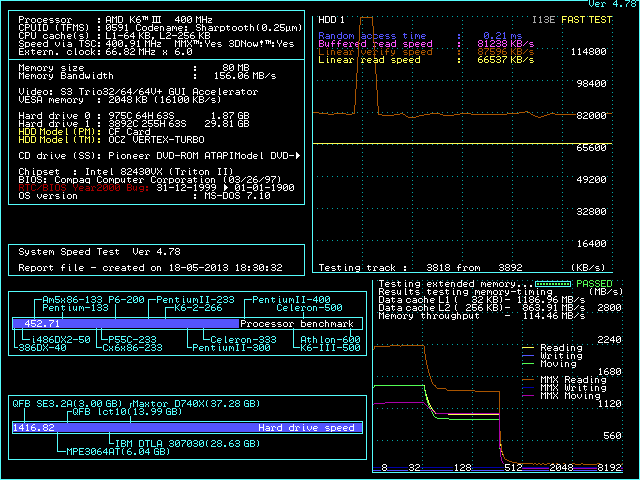

Reply 12 of 15, by vetz
Half-Saint wrote:
Have you worked this out? Interested to hear about the results... thinking of doing the same.
Works fine with the Silicon Image card bought from Ebay (http://www.ebay.com/itm/4-SATA-S-ATA-Port-RAI … =item2556a904ec). Be aware NOT to use the VIA chipset card linked in the first post. It has no BIOS and is not bootable!
No drivers needed in DOS or Windows 98 unless you are using the RAID functionality.
The speed is also crazy (buffered read speed of 81000 kb/sec, while RAM throughput is 114 MB/sec), see picture from Speedsys
