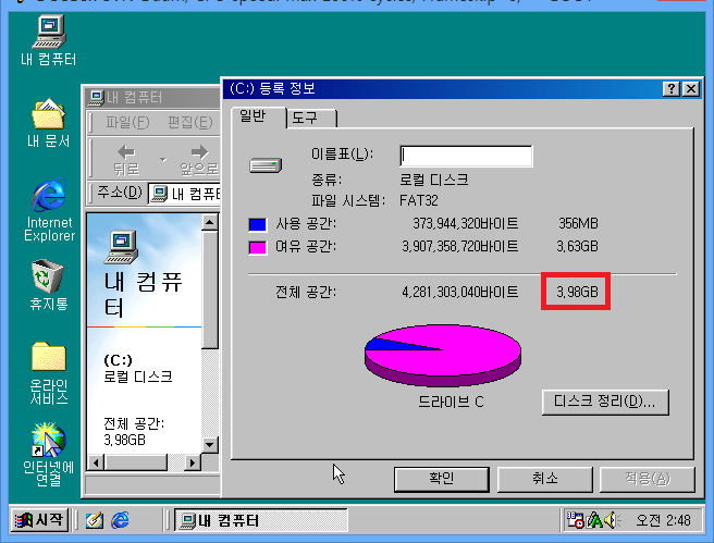

DOSBox cannot mount ISO images larger than 2GB due to some 32-bit functions (fseek/lseek/...) It is required to update the code in order to use 64bit functions that resolve the capacity limitation.
It led me to create a small patch to fix the issue against the current SVN. In my experiment, I was able to mount 4 gigabytes of hard disk image in DOSBox.

Reply 2 of 85, by ykhwong
leileilol wrote:
What are the limits with the patch, in theory? 110gb?
In theory? I don't know, but I think it depends upon the operating system and the file system.
Note that this is experimental and not a complete patch, meaning that it still may have some bugs. I confirmed that booting from my 4gb hdd img also works though.
