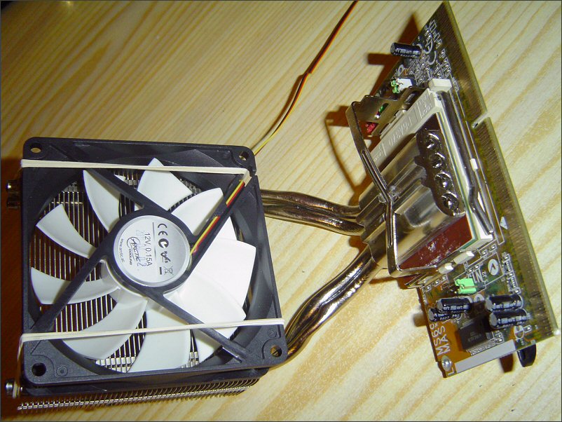

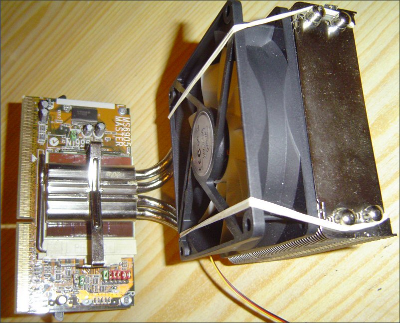

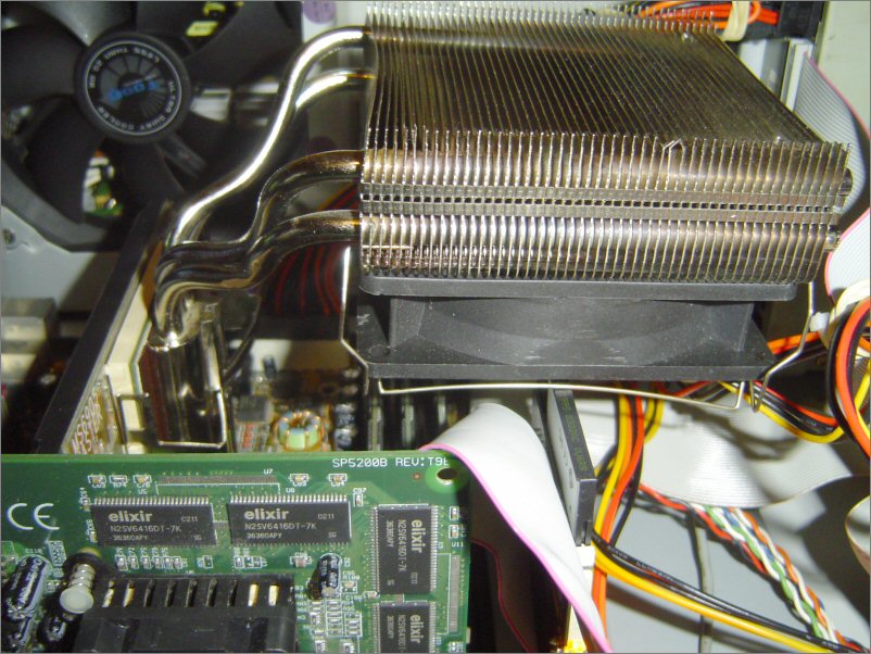

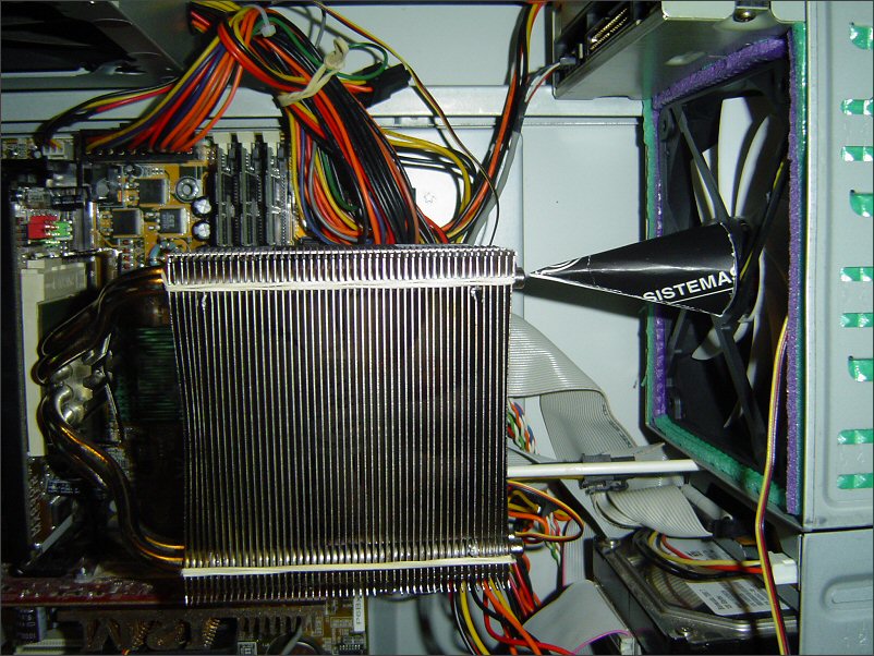

Ultimately I got fed up with the crappy Slot-1 cooling solutions and space constraints, and ghetto-modded my own aberration by bending 90 degrees a socket-A Thermalright SI-97 🤣 :

Reply 3 of 30, by Tetrium

Holy macaroni! 😳
Isn't the weight of that cooler too much?

Tetrium wrote:
... Isn't the weight of that cooler too much?
Been working like a charm for more than a year, 29 ºC idle / 33 ºC torturing with Prime95 @ 21 ºC ambient.
I wouldn't move the case by car with that thing inserted, however 🤣 .
