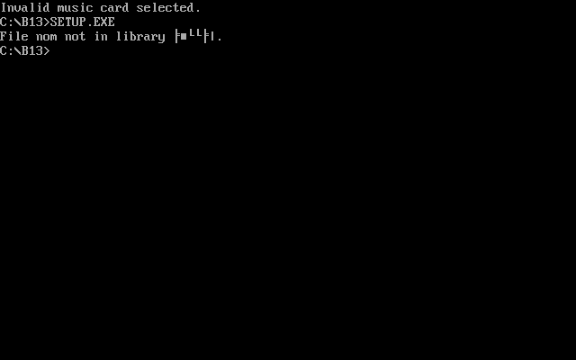

However I did find some timing related issues both with the patch you posted and commit 3791 of mpu401.cpp: neither Bureau 13 or Hell: A Cyberpunk Thriller will start with cycles set higher than 3000 (auto): you get an "invalid music card selected" with both if starting with anything higher; they even seem to corrupt memory after that (see screenshot), you can increase the cycles after the game has started and they work fine, though.
Reply 17 of 28, by HunterZ
What happens in 0.74?
Reply 18 of 28, by bloodbat
They work fine, at least those two.
Reply 19 of 28, by ripsaw8080
Rank DOSBox Author
DOSBox Author
The two games are developed by the same company, so it's likely they have the same issue. Is the result the same without the patch I posted?
