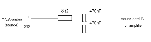

Reply 4 of 12, by Jo22
Hi, there!
Here's a small schematic for galvanic isolation.
That way, nothing should be damaged. You may also get cleaner audio.
(Btw, that tutorial is nice! ^^)
    2.37 KiB
    2337 views

Reply 11 of 12, by Megadisk
A quick update. I tried hooking that pc speaker connection to the SBPro2 spk input but there was way too much noise. So I went with a different route using the Teradrive headphone output connector and the SBPro2 LINE in input.
