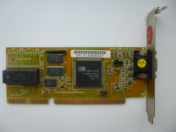

I found this card relatively recently :
file.php?mode=view&id=13782&sid=452251eabdd6d01b99301b56cf03bfd4
It is strictly a VGA card on the single chip CL GD-5401 chip. It uses 2 x 256Kx4 chips and 1 x 32Kx8 ROM. When I first saw it, I thought that it was highly probable that the card would work in an 8-bit system notwithstanding it had a 16-bit connector. I was right, it did. Oddly enough, it was made no earlier than the 10th week of 1995, a bit late for a strict VGA card. Obviously, considering the 8-bit RAM and ROM, the performance of this card is likely to be less than ideal in a 286 system, but with a 386 and ROM BIOS shadowing and cacheable video memory, the performance situation should improve.
However, one admires the minimalist design of the card. It cannot be pared down any further and retain the basic VGA essence. (It can't be upgraded either). The only thing it is missing from a full VGA card is the little-used feature connector. As far as DOS compatibility goes, it plays everything I can throw at it, including various Mode X games. Visual quality is not particularly remarkable.
Performance wise, I know the use of what is essentially 8/16-bit hybrid card is not going to give stellar performance. I tested this card in a 486DX2/66 with 16MB RAM. No external cache was enabled, the hard drive was running off a regular ISA IDE channel and the sound and music were turned off. DOOM 1.9s timedemo demo3 was used :
2134 gametics - 4460 realtics = 16.82 fps
Compare with its elder brother, a VLB CL GD-5429 card w/1MB RAM running in the same system :
2134 gametics - 2400 realtics = 31.25 fps

I have a quite similar card:

Along with minimalistic motherboard design, these were probably one of the cost-cutting solutions for late 386DX-40, which stil sold in quantity around 1995. With prices dropping, they were harder and harder to sell.
One less similar card to these two is Trident TVGA9000i-3 I got with my first retro computer. It has similar basic features: capability of working in both 8 and 16 bit ISA slots, small board, low memory (512KB). It was originally shipped in a PC with very minimalistic board with 386SX-40 soldered on.
Cacheable video memory? I know that BIOS shadowing is sometimes called cacheable video memory (even in BIOS setup), but IMO video memory must not be cached. On later CPUs the MTRRs can be set to use write combining for video memory, but I don't think that real caching would work. I just have to think about the whole EGA stuff, like read accesses loading internal latches etc., that would break with caching.
