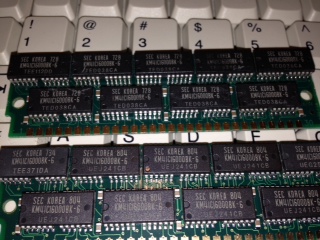

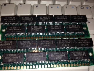

Let me see what I can do. The markings are really faint so I don't know how well they are going to show up on camera. I can't find a speed grade on them anywhere, it is possible I've got speed grades mixed as well which could be causing my problems because none of it is showing up now where before it was.
Reply 3 of 14, by snorg
Here you go, these are the best close up shots I could get.

Checked up the database, the pictures show 16M parity modules, 60ns, 16Mx1 structure.
As we're talking about 30-pin SIMM (I thought, you had more common 72-pin slots), you do have to insert 4 same sticks of RAM into each bank. Or are we talking about 486DLC? Pictures of CPU and motherboard would be helpful.
If you insert 2 16Mb stiks and 2 8Mb sticks in one single bank, you either get 32Mb RAM or nothing... It's the way it usually works for me.
