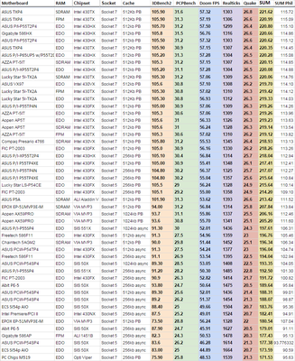

Current results:
285.47 KiB

Interesting how the VIA MVP3 with 1024K cache falls so far behind the 430FX with only 256K cache in 3DBench2.
Is the pipeline burst cache in the 430FX responsible for the socket 7 clobbering its same-chipset, socket 5, older brother? Do you have any motherboards which allow for asynchronous SRAM and a PB COAST module on the same board? It would be interesting to see the changes with these benchmarks. Was there already a thread on this? /me thinks there was.
Were there any 430HX boards which allow one to plop in an AMD K6-3+ with just a BIOS mod and no interposer board? I suppose this was one of the glories of the 430TX.
Very nice work Vetz. You certainly have a nice stash of socket 5/7 boards. One day I'd like to run a similar comparison with my holdings of 486 and 386 motherboards.

Yes, basically the cache type has alot to say. If you look at the results my FIC PT-2003 board has been tested with 256kb, 512kb Pipeline Burst cache and 256kb async cache. I also have a ASUS P55 board (430FX) which supports both types of cache (COAST and DIP sockets), but the keyboard DIN plug has been damaged and needs to be replaced.
Excuse me, I was so focused on the chipset and cache column I didn't pay sufficient attention to the motherboard type.

Current results: https://dl.dropboxusercontent.com/u/57506833/vogons/diverse/motherboards_P100.PNG […]
Current results:
Pretty consistent with numbers, that can be found in c't: Mercury/Neptune < Triton Async < Triton PB.

I sorted the results and the two HX boards are barely still on top 😀 Your results seems pretty consistent with mine. I'll post a new updated picture in the first post later.
