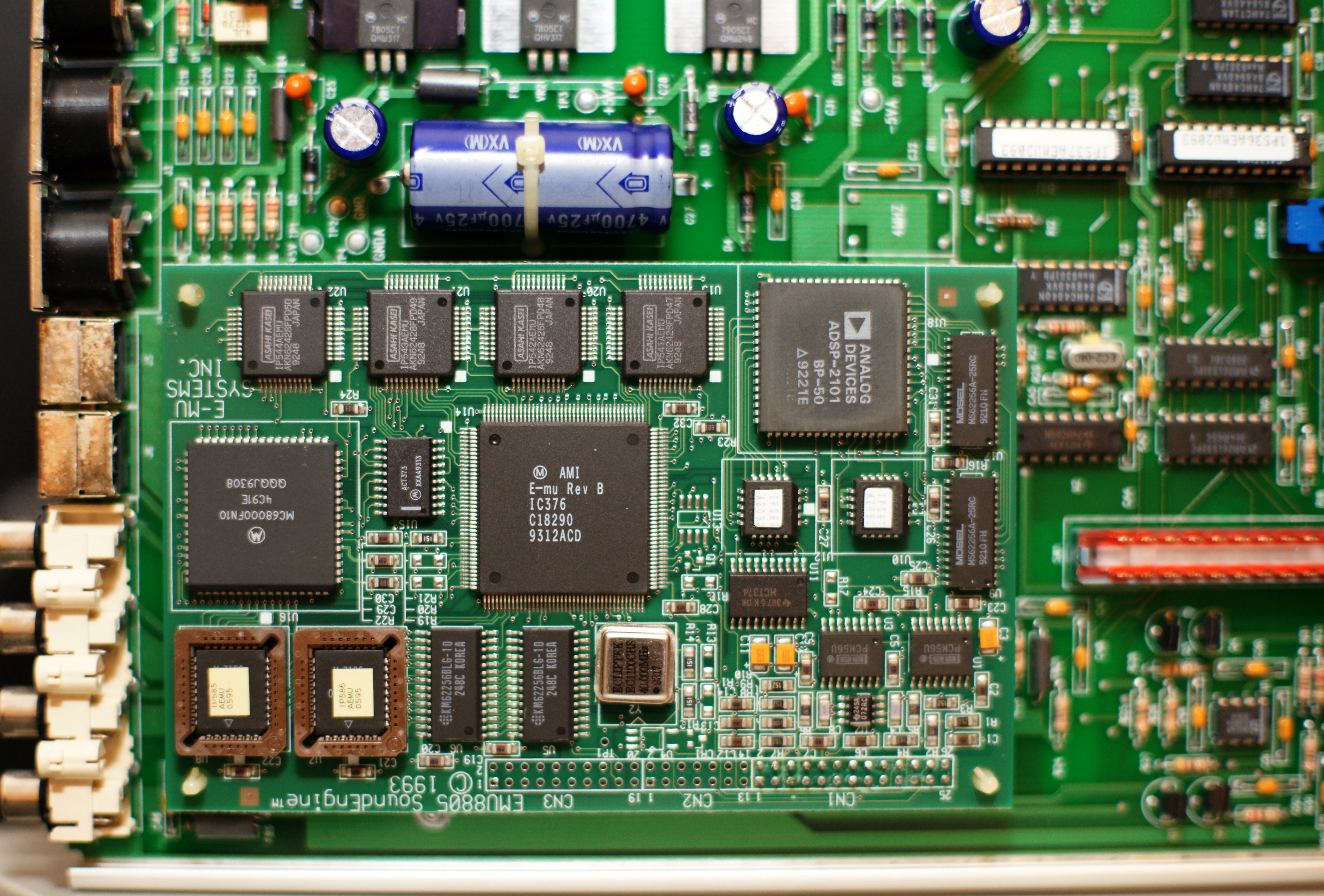

Hmmm... now HERE'S something that I didn't know before. re: this thread -> http://queststudios.com/smf/index.php?topic=3529.0 , and this pic -> http://www.ym2149.com/temp/emu1.jpg .
In that thread "Stefan_L" states that (referring to the EMU SoundEngine):
Inside it is an EMU8805 PCB... with waveblaster connector.. or reversed version of it i guess.
Then, have a look at the pic... QUITE INTERESTING! 😀
Rich ¥Weeds¥ Nagel
http://www.richnagel.net

So wait 😁 EMU SoundEngine is *basicly* the module version of Waveblaster 1 (Although with effects) ? IF SO, IT IS EXACTLY WHAT I'M LOOKING FOR 😁
If it's true, i am SO gonna buy it! Damn.
Of course, nothing is 100% guaranteed, but that's exactly what I'm thinking 😀
