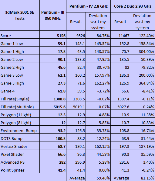

Reply 13 of 40, by gandhig
obobskivich wrote:
If I remember right gandhig has reported numerous issues with a PCI version of a newer nVidia card, I forget if it was a 5xx or 6xx board though. Might be worth a quick search.
As far as a quick PCI card, the fastest "native" card I'm aware of is the Quadro FX 600 PCI, but something like the GT 610 should probably be faster in theory. I don't know if you'd realize much of that though - most of the newer cards' advantages will be with shader performance in newer titles, which will be hung-up by the Pentium IIIs, PCI interface, etc more than anything else.
I was actually controlling myself not to post in this thread as my GT520 PCI was longingly looking at those PCI-X slots, the reverse PCI bridge being 66MHz capable(but not 133 MHz or whatever the latest PCI-X version defines) and is also not 64 bit capable. However feipoa had earlier mentioned that in one instance, it was not always a happy understanding between the PCI graphics card and the PCI-X slot.
I may deserve it if someone in this forum wants to have a go at me for bearing with my GT520 fiasco till now 😵 . Warning: But I can't take responsibility for whatever follows, as my hand has been forced 🤣 .
Here we go. Due to the onboard reverse PCI bridge in modern GPU's, there is a definite penalty in performance especially in older systems(which is more prominent before P4) compared to a native PCI based graphics card. I can't be 100% sure however as there may be some role of the nvidia driver(not optimized for this setup)in it, but the end result is what matters. If the OP has enough patience, he can check this thread wherein joint testing/inputs by SPBHM, feipoa, Standard Def Steve, d1stortion, swaaye, kithylin and many others has proved it sufficiently.
IMO, even though these old 5 or 6 series Geforce cards are native PCI, the GT520/610 or even better the GT430 PCI should be much faster in a system with more juice(like the OP's dual Tualatin) by means of its modern architecture especially in modern games. Importantly if the OP wants to play games upto 2001-02 he would be better off going for a old series native PCI graphics card that involves no risk. However if he gets greedy and wants to stretch that to slightly more modern gaming upto say 2005-06 and HD video/flash acceleration, he may atleast benefit from the modern GT430, if not GT520/610 PCI. The resolution sweet spot for this GT520 PCI card (or) PCI bus (o)r both seems to be 1024x768(not much fps hit) which obviously depends upon the game complexity,coding and other features too. Hence it can't be generalized and just an observation. Below is a chart showing performance that can be expected of GT520 PCI in different capacity systems:
The attachment 3dMark01 Comparison.png is no longer available
Another thing is that my case was slightly different in that my P3 is relatively underpowered coupled with the probability that the 'VIA' chipset's PCI bus implementation is not upto the mark. The missing hub architecture between the north-south bridges might have played a role too. So the OP's case seems to be on the better side, but obviously no miracle can be expected.
The Zotac GT 610 PCI is just a rebrand of the GT 520 PCI(6+1+0 = 5+2+0 = 7, it's the same 😎 )
