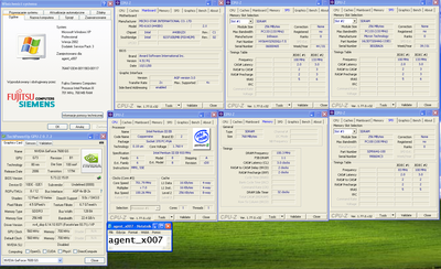

Reply 14 of 18, by agent_x007
"Ultimate" answer :
545.27 KiB
1512 views
Where is "the catch" ?
Well, it hangs/freezes on doing anything 3D related 🙁 (can play saper in Full HD tho 😀 )
Pro tip for future brave men :
Use less than 32MB in "AGP Aperture Size" - it helps in avoiding "Not enough resources" error.
I will try to make it work, I soo want to run Crysis benchmark on this 😀
