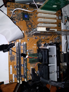

Well, you just gotta love it when the board you bought as nonworking not only works but boots into DR-DOS and accepts a BIOS reflash flawlessly. The board is a FIC SD-11 Rev 1.8 (the actual release version) I bought 10-15 bucks (not including shipping) to use as a comparison to the NOS Rev 1.7 board I bought a few months ago. They looked identical so I bought it to check under the NB heatsink to see if the difference was a more recent NB stepping. Turned out no, they both have C0 stepping NBs best as I can tell but maybe the stepping number is just really faint? It was a massive pain to read the other numbers so it's not impossible. The only real issue this board has is a bad PS/2 keyboard jack (the speaker just beeps when I push a key) so I might just replace it with a color coded jack because I don't have a I/O shield for this mobo. It does work with a wireless USB Keyboard/Mouse combo plugged in but sometimes it quits working after a reset. So, it looks like I'll have a control when I get around to repopulating the unused VRM slots on my NOS board. It'll be interesting to see if the instability issues Redhill mentioned and general PSU fussiness wind up being resolved by having the full 8 mosfet VRM that Compaq used on the Aspen 2 boards. I suspect so: the PSUs Compaq used had only a 30 amp 5 volt rail, lower that what Redhill found worked well (35 amp). As it is the board boots into a minimal DR-DOS bootdisk and runs the BIOS flasher without issue with a 700mhz Slot A T-Bird using a modern (IOW, weak 5v rail) 650 watt 80+ Bronze EVGA psu without any problems!!!

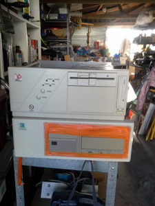

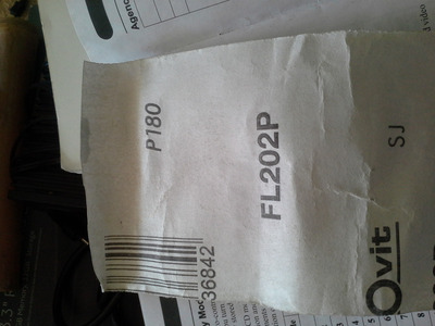

The fronts of both cases cleaned up well.
On the bottom one I used P180 FL202P Ovit sanding paper to get rid of the yellowing. No disassembly, soaking in water/oxy mix out in the sun for a few days so no chance of getting patchy. Done in about half an 3/4s of an hour.
The top case just needed a good clean with hot water and soap.

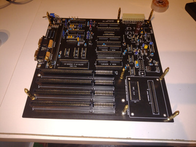

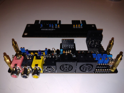

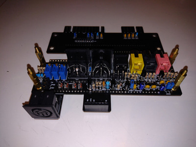

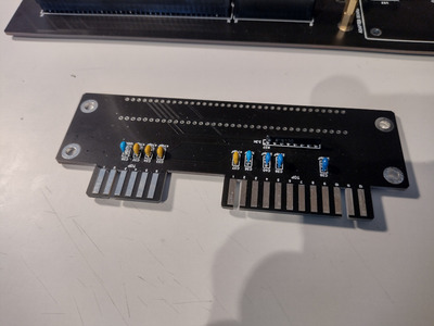

I have been working some more on my ATX-64 build. Still missing to build those extrenders, that connects the two daugherboard's/riser-card's, get a cartridge-connector, have a custom Rom created and buy the last 50% of the chips. Other than that, then I will have to find a case and a PSU.
But the build will not be complete when all that is done. There are Ps/2 keyboard adaptor, that I need to buy and build, as well as an internally mounted PI-1541 drive. (sorry about the last picture's brightness. Hard to take photo's of black PCB's)
The copper standoff's will be removed, once the build is done. They are only there to prevent me from bending components out of shape, when I solder. And to make a flat surface to solder on.

Still waiting for the pinheader extenders to arive, so I can have it assembled for checking if all sockets have contacts and to make a first power-on test. 😀

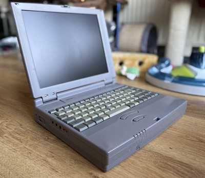

Cleaned and tweaked the Toshiba Satellite 300CDT.
I disassembled whole thing to the single screw, then cleaned deeply. Also, I've changed the internal batteries and replaced the thermal paste.
Then, I replaced CCFL to the LED strip in the TFT module. After that, I assembled it again.
1.64 MiB
1062 views
Now it's beautiful and clean. Also the screen works perfectly with the LED instead of CCFL tube (tested this one by connecting to lab power supply). However, I don't have any step-up driver to pick up from the shelf, so Toshiba needs to wait a week for completing this restoration.

that is pristine! great approach using LED too

I've seen boards having blank spaces but good god, that's almost half of the board that's being empty.

The AnandTech review said that the board had a definite "Prototype rushed out the door" feel to it. My suspicions are that the board was originally an OEM only product whipped up by FIC for Compaq to their specs with some eye to a later standalone release (hence the ISA slot that is unused in the Compaq board). I think all of the revisions were seeing how much they could strip off the board and still have it somewhat stable while working around the 751 NB's eccentricities, with 1.7 being the last preproduction version and 1.8 being the actual release version (they are both compatible with the most recent bios version, so I suspect the differences are very slight). Anandtech also mentioned overclocking options in the bios, but neither the most recent bios nor the bioses on both boards I have show any such options. I have a full set of polymer caps for one of these boards, but I might just use polys on the VRMs as well as the chipset power caps and use electrolytics on the memory side of the board. I have some electrolytics for the small value caps, but I probably won't worry with them unless I start getting some weirdness.
