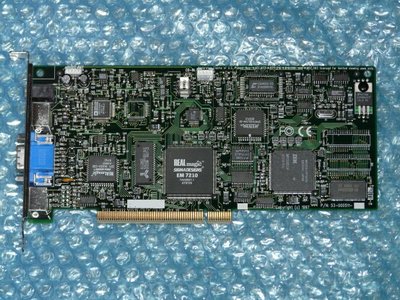

Reply 1 of 23, by Stiletto
I've a REALmagic Hollywood Plus DVD/MPEG-2 Playback card. Here's a brief excerpt from the installation manual:
Note: If you are installing a DVD-ROM drive at the same time as the REALmagic Hollywood Plus DVD/MPEG-2 Playback Card, remember […]
Note: If you are installing a DVD-ROM drive at the same time as the REALmagic Hollywood Plus DVD/MPEG-2 Playback Card, remember to attach the CD-Audio cable from the DVD-ROM drive to your sound card. Otherwise, you will not be able to play CD-Audio titles with the DVD-ROM drive. This will not affect the audio of DVD-Video or DVD-ROM titles.
Chapter 2: Hardware Installation 6
Video Connection
Your REALmagic Hollywood Plus DVD/MPEG-2 Playback Card must be connected to your VGA card or your PC's VGA output port in order to display MPEG video on your VGA monitor. (Refer to Figure 1 earlier in this Chapter for reference.) Follow the steps to connect the DVD/MPEG-2 Playback Card to your VGA output (see Figure 2).
1. Attach the round 9-pin DIN connector of the provided External VGA Pass-Through Cable to the VGA IN connector at the back of the REALmagic Hollywood Plus DVD/MPEG-2 Playback Card (refer to Figure 1).
2. Attach the other end (15-pin "D" shape) of the cable to the output port on your VGA card or your PC's VGA output port.
3. Connect the VGA cable from your VGA monitor to the VGA OUT of the DVD/MPEG-2 Playback Card.
Figure 2. Video Connection
Chapter 2: Hardware Installation 7
Audio Connections
There are two audio outputs on the REALmagic Hollywood Plus DVD/MPEG-2 Playback Card: the Stereo Out and the S/PDIF connector. The Stereo Out outputs a standard analog stereo signal that can be used by virtually any stereo receivers or amplified speakers. It also contains the Pro Logic Surround Sound encoding that allows you to achieve surround sound by attaching this signal to a Pro Logic receiver.
If your system has a sound card, we recommend attaching the Stereo Output signal to the LINE-IN port on your sound card, and then attach your Pro Logic receiver or speakers to the LINE-OUT or SPEAKER port on your sound card. This will allow you to use one set of speakers to listens to both DVD/MPEG-2 audio as well as other types of audio from your sound card. It will also allow you to control the volume by using the mixer program provided with your sound card. A standard mini jack audio cable can be used for this audio connection of the DVD/MPEG-2 Playback Card and the sound card. Otherwise, attach this signal directly to a Pro Logic receiver or speakers. Connect your Dolby Digital Surround Sound receiver to the S/PDIF connector. This signal contains all six Dolby Digital Surround Sound channels.
Figure 3. Audio Connections
Chapter 2: Hardware Installation 8
TV Connections
There are two options for connecting your REALmagic Hollywood Plus DVD/MPEG-2 Playback Cad to a television: S-Video by using a standard S-Video cable, or composite video by using an S-Video to Composite converter cable.
The REALmagic Hollywood Plus DVD/MPEG-2 Playback card can be connected directly to a TV using an S-Video cable. The S-Video TV Out connector on the REALmagic Hollywood Plus is a 7-pin S-Video connector, which can be connected directly to a TV using a standard S-Video cable. If your television set does not have an S-Video input port, you may connect it the the REALmagic Hollywood Plus by using an S-Video to Composite converter cable.
Composite Video is more common and works with most televisions.
The S-Video connector provides better picture quality.
Figure 4. TV Connections
Chapter 2: Hardware Installation 9
Advanced Connections
The DVD/MPEG-2 Playback Card also includes an internal CD Audio In connector that allows you to pass CD audio through to the internal CD Audio In connector on your sound card. To do this, attach the CD audio cable from the DVD-ROM drive to the REALmagic Hollywood Plus DVD/MPEG-2 Playback Card, then attach another cable from the internal Line Out port from the REALmagic Hollywood Plus to the CD Audio In connector on your sound card. Please refer to Figure 1 for the locations of these internal connectors.
The signal from the Line Out port combines the CD Audio In signal from the DVD-ROM drive with the same signal that is output through the Stereo Output Port on the REALmagic Hollywood Plus. This solution eliminates the external audio cable that normally goes from the DVD/MPEG-2 Playback Card to your sound card.
If you are using this solution, attach the Pro Logic receiver to the Line Out port of your sound card to obtain the surround sound signal.
Note: With this solution, the volume for both CD audio and MPEG audio will be controlled by the CD Audio portion of your mixer.
Note: Due to the copyright protection circuit in use by this product, please do not connect any recording device, such as a VCR, to the Composite Video Out or the S-Video Out connectors of the DVD/MPEG-2 Playback Card. For best playback, make sure the DVD title is played directly from the DVD/MPEG-2 Playback Card onto a TV, not through a VCR.
Chapter 2: Hardware Installation 10
In summary, you need the custom proprietary 9-pin DIN to 15-pin DSUB (VGA) cable to connect your decoder card to your video card, and then you connect your monitor to the 15-pin VGA connector on the decoder card. Running the internal audio cable is optional but allows you to eliminate the external audio cable that runs from the back of the card to your sound card.
I may have an older card than you though, mine expressly came with Microsoft Windows 95/98 support only if I recall correctly. Hope this helps.

Reply 2 of 23, by Roman78
Do you have a Driver CD? Just bought this card on ebay without anything, so I don't have a driver, found some on the internet although I would like to have a copy of the original CD. Could you make and ISO and upload is to vogonsdrivers.com?
And are there also DOS drivers available for this card?
I have a REALmagic Hollywood Plus also. No driver CD though, only floppies:
No DOS drivers that I know of, either.

Reply 5 of 23, by Stiletto
Roman78 wrote:
Could you make disk images of those two disks (e.g. with WinImage) and upload those, or e-mail those to me. I trust those more than some downloaded files I found on Google.
If he can't, I can.
IIRC my card did come with a CD (actually a double-sided DVD I believe) but it just had sample videos on it and no software, the drivers came on floppies. I'll check before the weekend.
Still, I think VOGONSDrivers downloads are generally more trustworthy than the average DriverArchive download found on Google 😉
http://www.vogonsdrivers.com/getfile.php?fileid=72

Reply 7 of 23, by bnewland
Not sure if anyone still needs the driver cd, but here is an image of mine. The PCI card is a Rev. A4., P33L4964. Hope it helps....Here is the README.TXT
README.TXT For REALmagic Hollywood Plus(TM)
Release 1.6.2 (B.113b) ------ 5/20/99

Just saw this thread and have newer drivers and DVD Station (2.0 Build 86) . How to upload them to the Driver Library?
2011 i wrote a mail to Sigma:
Hello from Germany, […]
Hello from Germany,
I have a RealMagic EM7210 here and i can't find something about this card.
Just found one image in the web. All other sites who talk about this chip talking about netstreaming cards and they look different.
I bought this card around 1997 together with a Philips DRD 5200/30 DVD-Rom.
Must be one of the first DVD-Rom player. It also had come with the game "Muppets Treasure Island" and
on the cover it says "Enhanced DVD-Rom Edition offered only with Philips DVD-Rom kits".
On the manual it says "REALmagicDVD Hollywood 2" but the Hollywood cards look different.
And if i remember allready in 1997 in was confusing to find driver on your website
because the floppy disks hat not "REALmagicDVD Hollywood 2" on the lable.
The SN is 0543143 and the P/N 53-000511.
Must be one of the first SigmaDesign cards 😀
Would be great if you can tell me what card this is and can give me a link to Win95/Win98 drivers and software.
The answer was:
Thanks for your detailed info. Yes, this is a very very old Hollywood 2 board. Here attached are the Win 95-98 drivers for the region 2 DVD playback (Germany/Europe).
Sorry, no drivers for more recent Operating Systems. Next message will have the applications disk. Please read the readme.txt file for installations procedures.
Note also that there is no support for this very old board.
Back then i bought the card and DVD-ROM cause i wanted to watch DVDs and have DD 5.1.
DVD Players where really expensive when they came out.
Ok the card and DVD-ROM weren't cheap neither. I paid 600 German Mark - that was ~350$ back then.
EDIT
Ok confused by the date of the readme i saw my drivers are not newer but for the Hollywood and Hollywood 2.
The Hollywood Plus is a newer card (1999) and my card is from 1997 😀
The Plus had DTS output?
Here is my card:

And when did it start that those cards where no longer needed? CPU or MPEG2 decoding with graphics cards...
I remember the Sigma Reelmagic MPEG1 ISA decoders and the Sigma Real Magic Hollywood+ ("Plus") PCI MPEG2 decoders; different cards that themself were built with different chips revisions/numbers on various pcb layouts/designs together with different onboard rams and tv-out chips etc... (I suppose Hollywood 2, Hollywood+ and Hollywood Plus, same cards) but still the various Hollywood+ revisions were similar and worked on the same drivers up to the 2003 when later they did the X-Card PCI mpeg2/4 decoder which is a "better" card but in a time were cpu and gpu and softwares were the easiest solution. Creative Dxr3 was based on the same H+ design and that too had different chips/revisions of the same named board. I've seen different final video quality of these revisions that might explain why they existed/improved.
The Pentium 2 in the 1998 with a good dvd software player had already the power to decode (with the help of MMX instructions and some basic vga "acceleration" that most cards had already) the mpeg2 process BUT if intended to do that and nothing else; that's why these card were great because when/if configured correctly could bring down cpu usage even in low K6-2 cpu to 10/20% when a software dvd player using only the average Pentium 2 maybe 70% cpu usage probably. But with the decoder cards multitasking were possible with mostly no cpu usage difference and a smooth and high quality image (if compared to 90's sw only decoding and considering the CRT monitors target). Also the basic cpu requirement for these decoder cards were around 166Mhz systems.
In the late 90's vga began to support a bit more of the "usual" basic video process and ATi (SiS too, S3 also..) was one of the first to accelerate part of the (rest of the not already accelerated) process into their chip, the motion compensation support reduced let's say ipotethically 30% less of that 70% above cpu task and later the IDCT acceleration into their chip offloading another part of the whole process. Some vga still didn't have that support or only had motion compensation (others not even that). Software dvd players supported these hardware functions plus SSE instructions and 3DNow!s and decoder cards began to have less reasons to be used. Cpu became also much more powerful, vga began to have DVI output and LCD were not intended to be used or had difficult time to find a good image quality on these cards.
That said, even if a Pentium2/3 around 400/500Mhz seems to be enough with a period correct vga, at the end it would not in multitasking and the cpu would seriously have difficult time. Without a vga supporting also both accelerations, multitasking during mpeg2 decoding was still difficult even with later cpus than that.

I checked the date on my first DVD-ROM and it says February 1998 (Philips DRD-5200/30).
Thats the drive that came with my Hollywood 2 where i posted the image above in 2015.
I'm not sure when i bought the first Dolby Digital amp that i can connect it to the Hollywood.
Just realized that a Pentium II 233 was my first HTPC 😀
What was the first Dolby Digital sound card?
