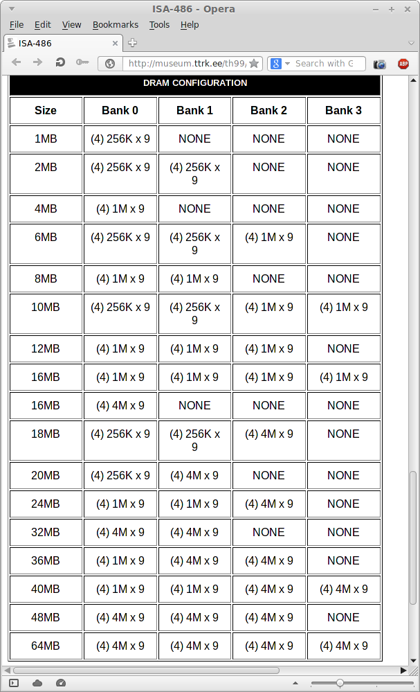

Have found two sources of infomation
http://museum.ttrk.ee/th99/m/A-B/31880.htm
http://www.cabrillo.edu/~marcelo/current/170/hw4.pdf
The second is a homework assignment that just happens to have good & useful information about this r1.3 board.
Reading the jumpers, I see it has the full 256kb cache and was fitted with a 486DX 33.
