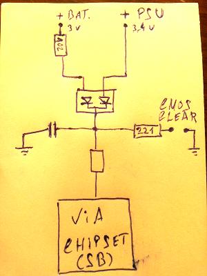

Reply 11 of 13, by rick6
Well i want to thank you both for your knowledge and explanations because it made me understand much better the "workings" of the cmos battery and cmos clear circuitry.
I've made this small schematic according to what i was able to pinpoint with my multimeter.
16.91 KiB
1747 views
I measured 3,02v right before the "102" resistor and about 2,98v after it (give or take a few mV on these voltages). Then after that unmarked resistor that feeds the VIA chip i got about 2,66v. One thing that i would notice was that when the board was turned off and unplugged from the mains, if i shaked it even if a tiny bit, the voltage getting to the VIA chip after that unkarmed resistor dropped considerably to 1,5v or even less, and then back to 2,66 (it was all over the place sometimes). If i did the same thing but measured the voltage before that "102" resistor it was always above 2,5\2,7v, but in extreme cases it would get even lower than 2,5v, meaning that nearly no voltage was getting to the chipset.
Well, the only thing before that "102" resistor was the battery socket but i already had it cleaned with alchool a few times. Then i pressed the positive of the battery socket really hard with a screwdriver and the voltage wouldn't drop anymore with minor shakes of the board.
I couldn't believe, it was the battery socket all along?...I cleaned it again with KONTACT spray and bended the contacts really hard, tested it and the bios settings weren't being lost anymore!... I felt a bit bad for so much work and in the end it was a oxidized battery socket. D0H
But it doesn't end here...after i assembled the board in the computer case and turned it on the bios settings were LOST again -_-
I decided to replace that socket with one from a dead motherboard and now everything working has it should.
Incredible, so much work and it was so simple in the end 🙁
I know that you suggested dirty battery contacts but man...i had them cleaned with achool 97%...i could swear that the problem wasn't there.
I think that by adding that 100 ohm resistor in parallel with the "102" smd resistor i was involuntary able to "alleviate" the voltage drop caused by the oxidized(?) battery socket.
Btw pardon my ugly hand writing and have a laught about how my schematic looks like some weird robot from the 80's.

Reply 12 of 13, by Maeslin
That's actually a pretty damn good schematic.
As you've learned, alcohol is unfortunately not all that great a contact cleaner. Won't help at all for corrosion, only for some forms of gunk (on other types of gunk, I've had to use brake cleaner before it had any effect!).
Something that may be useful for such situations is a combination of emery board (small nail file) and nail polish remover/acetone but you have to be careful with the latter because it will also do a mess of most plastics. The emery board is perfect for scarping corrosion off contacts.
Another alternative is a simple popsicle stick with a piece of super-fine sandpaper glued to it.
From the tests you've done, resoldering that unmarked resistor might also help. Dry or cracked solder joints on SMD components can be a pain to find and it can't hurt to touch things up a bit.
