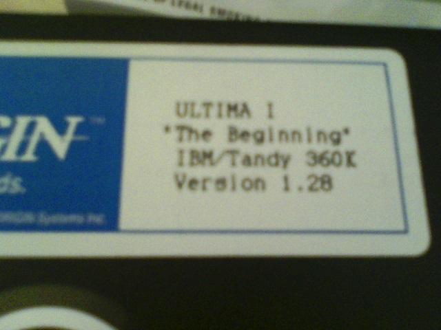

Reply 12 of 81, by NewRisingSun
FeedingDragon wrote:
I know the version of Ultima 1 (v1.28) only because it's marked on the label.
Oh? Care to show a picture of the disk label? I don't think I've ever seen that. What is the date of ULTIMA.EXE?
On these disks Ultima 1 & 2 use the same copy protection method (I can give very specific details on those because I found them with a search.) Both have an altered track 6 side 0, with the overlap I mentioned above. First, each sector is 1024 bytes. Sector 1 is 8192 bytes (but overlaps sectors 2-8,) and reports a CRC error. That's what the web says.
That's OSI-1.

Reply 13 of 81, by FeedingDragon
The date of the EXE is 12/29/87
79.95 KiB
7611 views
Feeding Dragon
