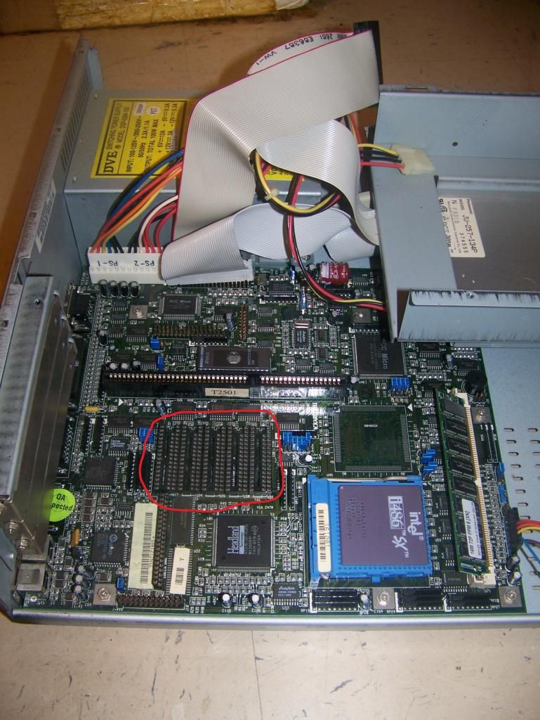

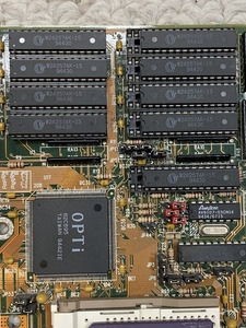

trying to upgrade the L2 cache ram in this machine. its supports 64,128 and 512k of L2 cache (but not 256k interestingly).
by issue is I'm not sure what I need to get 512k. right now I have 128k via 4 14 pin 32x8 chips + 1 for tag ram.
I bought 5 128x8 chips and they arrived today but there the wrong type. there the same width of the chips I have installed now but longer (16 pin). so I guess what I need is 128x8k 16 pin wide chips? I'm just worried of wasting time/money getting the wrong kind of chips again. can anyone tell me exactly the name of what I need or point me to some for sale?
Reply 1 of 19, by Jolaes76
You definitely need the motherboard manual to find out the arrengement, type of chips and jumpering
It is possible that one bank can be upgraded only by a special sipp type chip for 512 kb total.
Being a Packard Bell, it must have a manual somewhere...

Are there solder pads on the motherboard that would let you add the the two extra pin holes?
Please remove the red barrel battery too before it leaks acid all over the board.
Reply 3 of 19, by Jolaes76
The sockets are 32 pin but the wide type...
Dig up the the old Packard Bell ftp site, you might unearth some info
ftp://ftp.packardbell.com/pub/itemnr_ol ... SH/OLDIES/DESKTOP
and
http://pbclub.pwcsite.com/PBFTP/
plus
http://www.uktsupport.co.uk/pb/pbidx.htm
here, jump to:
http://www.uktsupport.co.uk/pb/mb/pbmb1.htm

Reply 4 of 19, by soviet conscript
thats the first thing I did.
my motherboard appears to be http://www.uktsupport.co.uk/pb/mb/410.htm
it says the cache chips are the same as for the PB430 which says
"Cache memory on a PB430 can be upgraded to 512kB by installing four 128kx8 cache chips (at locations U15, U19, U24 and U30) and one 128kx8 tag SRAM chip (at location U35) "
but I already knew this. It doesn't mention anything about proprietary chips or specific sizes just that I need 5 128kx8 chips...which I have...which are the incorrect width.

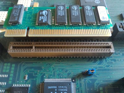

Reply 5 of 19, by lazibayer
I need some help about cache for 486, too...
It's for FIC 486-GAC-2, which uses a quite odd shape of cache slot that looks like the shorter portion of a VL-bus. The slot is located aside the CPU slot:
images?q=tbn:ANd9GcQPhuWy5doU3XkMtV8fdUJTa6ehF3YkDxi9kUhyjFJrGC0NkB59
What's the key word should I use on a market search for such cache module? Thanks.
Reply 6 of 19, by soviet conscript
lazibayer wrote:
I need some help about cache for 486, too... It's for FIC 486-GAC-2, which uses a quite odd shape of cache slot that looks like […]
looks like a slot for a COaSt module or "cache on a stick" BUT most of the COaST sticks on ebay are for Pentium machines. I didn't even know any 486 motherboards besides the m919 uses a COaST stick. Using the wrong COaST stick in that such as one ment for a Pentium board could do damage.
Reply 7 of 19, by lazibayer
soviet conscript wrote:
Yea Pentium coasts are easy to find. The slot looks totally different in shape than a Pentium coast slot.
Reply 8 of 19, by luckybob
thats the first thing I did. […]
Measure the width of one of the sockets. It will be either 300mm or 450mm. In all likelihood it is a special socket that accepts 300mm dip 28 OR 450mm dip 32. Then its as simple as a bit of google-fu. I'd start with "sram dip 32 450mm 128k x 8 5v"

Reply 10 of 19, by lazibayer
A similar slot also appears on a Compaq Prolinea motherboard:
compaq-197023-001-486-motherboard-socket2-sbc-prolinea-tested-working_321577065568.jpg
Reply 11 of 19, by soviet conscript
Like I said, my PCChips m919 486 motherboard has a slot like that. I had to track down the special COaST module for it. took awhile. it was labeled "for 486 m919 use only" I assume your board has a similar proprietary module maybe?

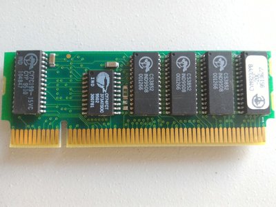

Reply 13 of 19, by lazibayer

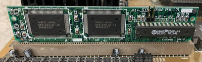

A little progress on this topic...
I found a picture of this exotic cache card that looks like a good fit.
From: http://ummr.altervista.org/x86gen.htm
Reply 14 of 19, by Tetrium
lazibayer wrote:
A little progress on this topic... I found a picture of this exotic cache card that looks like a good fit. http://ummr.altervis […]
I think I may actually have one of those CPU-like chips, but separated from any daughterboard and with pins and all, very similar to a 486.
Never really knew where its previous owner got it from. But it looked interesting (it had an extra row of pins I think, but spacing was similar to a typical 486 CPU).

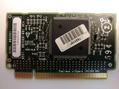

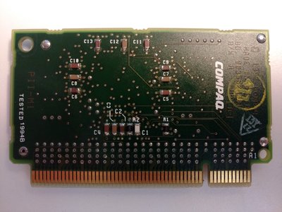

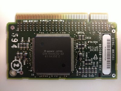

When browsing old computers on ebay I found some one was selling a non-working Compaq Deskpro 486 with the Prolinea motherboard that has a similar cache slot. So I asked the seller if he is willing to part it out, and he agreed and confirmed that the module is in working condition.
So I have it; under the Compaq label there is a Sony CXK784862Q-33 chip, and that's the only IC on the module.
851.95 KiB
2309 views
791.17 KiB
2309 views
837.49 KiB
2309 views
Unfortunately it doesn't work with the FIC board, though it fits right in the slot. The computer won't boot at all.

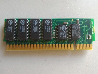

Reply 17 of 19, by lazibayer

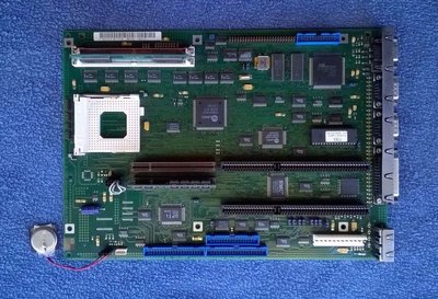

There is another possible choice: CYM9236/9237 cache module, which, according to the datasheet, are designed for UMC491 chipset, so the chances are probably against me again.
The whole story begins with me purposelessly browsing 486 parts on ebay and a motherboard from Olivetti M4 464 S caught my attention. It seems
to have the same shaped cache slot but I can't get much information about the cache module from the listing's gallery.
318.82 KiB
2308 views
So I asked the seller if he could take some clear pictures of it, and he kindly did.
246.35 KiB
2308 views
254.9 KiB
2308 views
385.36 KiB
2308 views
That's how I got its model number. I don't have it; the pictures are all taken by the seller and I didn't want to ask him to part out a working combination.

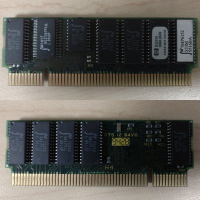

Reply 18 of 19, by lazibayer
Bought this cache but still not the right one 😵
I hate things that are not fool-proof 😠

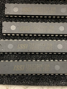

Reply 19 of 19, by douglar
I have a Shuttle HOT 419 Socket 3 motherboard. The manual says it can do 512K L2 cache if I have the larger DIPs. I had some 10ns chips. I pulled the old SRAM ( W24257AK-15 94430 ), put in the new chips ( ISSI IS61C1024-10N JV530111L 1901) & made the appropriate jumper changes and got no boot. Put the old chips back in and it runs. Do I have the right chips or is one (or more) of the sram chips likely bad? The lone chip at the bottom is the tag chip.
