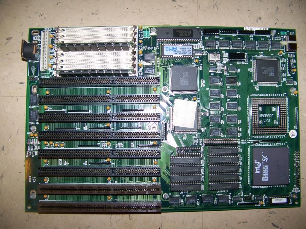

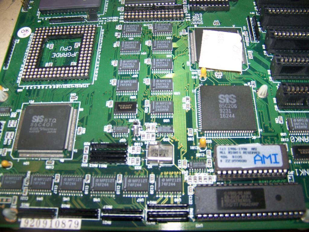

Just picked this board up at a swap meet. Can't find any information it but it looks to be a 386/486 board. Has 4335cl-p103 as well as fu yu 20 v0 printed on the back.

The SiS 85c401/402 chipset points to this NOT being an EISA board. The slots are likely a 32-bit proprietary local bus of some sort. Do not attempt to put a real EISA card in those slots, unless you want smoke.
Here is a similar board noting the local bus: http://www.funkygoods.com/mb/lc486c/lc486c.htm

🙁 well that would suck. I did also pick up what looked to be a eisa et4000 video card that was in the same box but I suppose there's no way to actually know it it's eisa or whatever this board may have.
Reply 4 of 8, by NJRoadfan
There is an "Opti Local Bus" that used the EISA edge connector as well that the ET4000 card likely went to. Obviously those boards used Opti 486 chipsets. I don't think any real EISA video card used a Tseng video chip.
Reply 5 of 8, by soviet conscript
Hmm the board and card cost me roughly a dollar. I may just stick the tseng card in, cross my fingers and see what happens. Unless I can somehow positively identify the board and card.

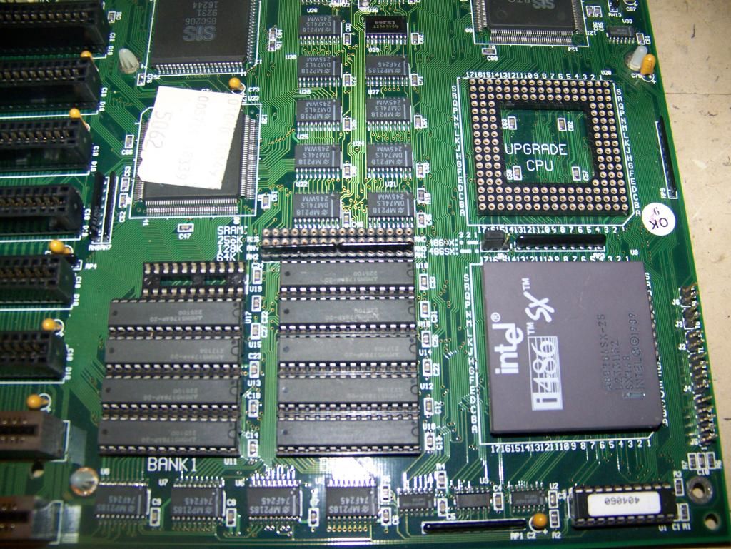

i guess its a moot point, cant get the board to post. its kind of odd that the entire board only has 1 jumper and its to select either 486sx or 486dx. I'm pretty sure its a RAM error. I get 3 long beeps, its an AMI BIOS and 3 short beeps is the code for ram error...to me its 3 long beeps cause its like beeeeeeep (10 seconds) X3 but since there is no error for 3 long beeps i'll just assume my and ami's definition of short beeps is different.
the FCC id on the tseng card is ia6et4kvesa32k
its there but I couldn't get anything useful from the information.

does anyone know what the "CPU Upgrade" socket it for? they never made a 487 did they? the box with this board also came with the 25mhz 486 and a 30mhz 386 but the 386 is to small for the cpu sockets.
*NM, apparently there were 487's*
