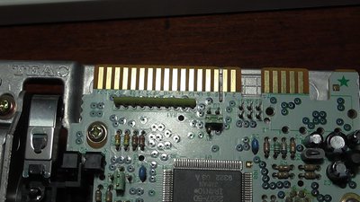

Hello guys, I recently bought this for 2$ but failed to notice that it doesn't use 4 pin molex. Is this some kind of proprietary drive or what it up with this?
    2.61 MiB
    1980 views
    Here is the connectors, both the data connection AND the power are card edge for some reason...

If I remember correctly, some 5.25 inch floppy drives get power from the floppy cable only - my uncle's Packard Bell had one of these. The floppy cable itself looked peculiar, a standard 34 pin connector with an extra 10 pin right next to it. Finding one of these cables will probably be difficult (haven't seen one since the late 90's).
Your Teac drive is indeed missing the 4 pin molex. Here are pics of mine to compare with:
Ooohh, the pain......
Reply 2 of 12, by HighTreason
You look to have the vias and pads for the Molex though, so you could solder one on.

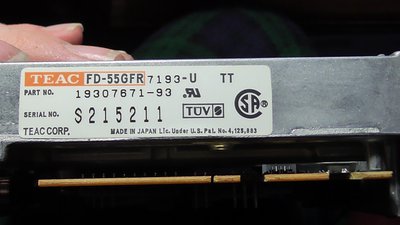

Reply 4 of 12, by King_Corduroy
Yup but I didn't pull up anything useful by google-ing the model.

From the look of that ragged black plastic item with the 5 metal prongs,
looks as if a connection, maybe with a flat ribbon cable, was ripped out.
Well, no big problem - probe the prongs to see if there is 0 ohm continuity
with certain of the empty holes where the normal power connection should
sit, probably there will be, so source a normal connection from an unsalvage-
able other floppy, and solder that in.
A 7193 being the most desireable of the 5.25" floppy drives, even if you decide
not to keep it, if it is in operable condition, then someone else will buy it... 😀

Uh... what black plastic thing would you be talking about because there simply isn't one. The thing that looks like a black plastic thing is really some solder points in the foreground with light shining through the case in the back. 🤣
It's pretty apparent there never was a molex connector on here.

Reply 10 of 12, by King_Corduroy
What you are seeing is the base of the connector for the read write heads ribbons.

I know that the 1000 series that could fit a 5.25" drive always had a Molex connector just for that or a hard disk drive. It looks like there were weirder PC OEMs out there.

Hey, here's a possibility to consider - I saw this pinout for a 3½
HewleTT Packard floppy drive and wondered if any of their
5¼ floppy drives used the same arrangement on their finger
contacts. (If that is a HP pinout then a test with a digital
multimeter should show no zero Ohm continuity between
the groups of 5V, 12V and GND contacts, but of course continuity
would exist 'within' the 5V group, within the 12V group, etc.).
http://www.retrotechnology.com/herbs_stuff/drive.html#35new
Something to test on your TEAC FD-55GFR 7193-U TT drive...
