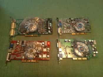

I did something very similar to my 6800U. I have some of the Chinese VF700-inspired coolers. Maybe you've already seen this shot. I had to trim down the fins of the 6800 RAM cooler to fit.
As to the true cooling needs of those RAM chips, maybe a part number search would provide some TDP info?
Clockwise: 6800, 8500, 5200, 9800.
