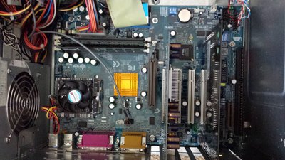

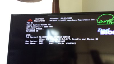

So, I got the following machine (will post pics later):
Gigabyte GA-7ZX motherboard (KT133, Socket A)
Duron 800 CPU
512MB PC133 SDRAM
CDROM drive
40GB hard drive

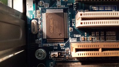

onboard SB PCI128 (CT5880 chip)
Radeon Atlantis 9600 256MB (AGP)
GeForce MX4000 128MB (PCI)
So, I put it together, brought it home, and successfully loaded Windows 98 SE on it using the Radeon 9600. Now the particular thing that made me choose this motherboard is that I saw an integrated Creative chip on it that offered DOS compatibility. It's labeled a CT5880, and is an SB128 PCI chip. The cool thing is that by installing the Win 98 drivers, it also edits the autoexec and config files with environment strings and makes a DOS utility folder (C:\SBPCI). After playing some DOS games via command windows and DOS mode, it works great for Soundblaster and General MIDI, although the sound quality is debatable. So next I installed my copy of Clive Barker's Undying but it stutters a bit. After researching, I realized that the little Duron can't quite keep up with the CPU overhead of the CT5880 chip (which I later learned utilized software rather than hardware).

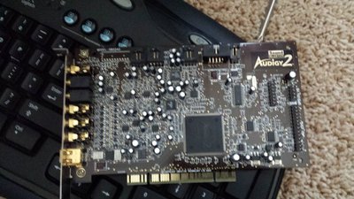

Fast forward to today, and I dug out my old Audigy 2 Platinum. After fiddling around, I successfully installed the Audigy on a fresh reload of Windows 98 SE, and got much better Windows sound. Fired up Undying, and yup, smoother frames! What sucks - no DOS sound. Also, the Radeon doesn't like SVGA modes in Tie Fighter (I found that out here). So I switched to the MX4000, and Undying still plays ok, but seems to be missing objects and textures. To fix the DOS sound issue, I reenabled the onboard CT5880 and installed the drivers in Win 98 (now having dual sound cards in Win98). I can now get DOS games to play sound, but (duh) I have to switch the line out cable to hear it.

1. Should I just use the onboard PCI128 for DOS (comes with ok 8mb soundfonts for GM, SB sounds somewhat ok) and use the Audigy 2 for Win98, or disable the onboard and add an ISA sound card? If so, which one? Any Windows conflicts?
2. If I keep the CT5880 for DOS and Audigy 2 for Windows, what would the optimal configuration be for getting Windows sound only from the Audigy and not letting the PCI128 mix in, but still get sound in DOS games?

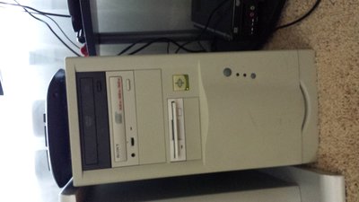

*Update 5/29 Here's some pics:

If you have an ISA slot, you really want an ISA card for DOS
You can just disable devices you don't want to be available in device manager 😀

As far as I know, Audigy and Audigy 2 has DOS support. There might be even some 3rd party drivers and the like might be involved, but I remember a full site almost dedicated to this issue. Googling may help.
EDIT: I just found a thread about that:
Audigy 2 unofficial DOS driver
In short, it is not suggested for many reasons.
