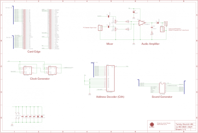

But for this i would rather have an 8bit multi PSG style standard ISA card. James Pearce told me the Tandy Sound Adapter design is finished, so we could combine several PSG in a single card. Fagear suggested AY-8930 but i don't know how easy is to make the board compatible with Covox Sound Master since the replica is not finalized.
But image a board compatible with:
Innovation (MOS SID)
Game Blaster (Phillips SAA1099p PSG)
Tandy (SN76489 PSG) no DAC
Sound Master (AY 8930 PSG) if possible...
This would be a board that would support hundreds of games, mostly with Game Blaster and Tandy support.
I don't know if its feasible to have Covox SM and Innovation in the same board since the default port on both cards was 280h.
In my opinion the best option to add Sound Blaster 2.0 and Sound Blaster Pro 2.0 + OPL3 would be using the YMF-71x chipset, which includes excellent codec and MPU-401 UART capabilities. Also YMF-71x cards are easy to source and have rather simple layouts which should be pretty easy to replicate.
Hypothetically the YMF-71x chipset could be used to emulate the Tandy DAC which would give additional functionality to the board.
Or we could make the board just AdLib compatible by adding a single OPL2.
Here's the schematic for the Tandy sound adapter btw:
