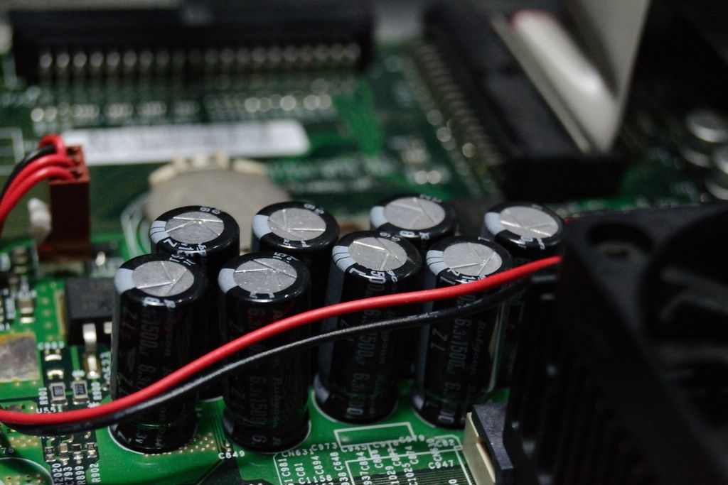

Reply 8 of 15, by mockingbird
rick6 wrote:
Caps look perfect on either the motherboard or psu. I know that that doesn't mean they are good, but to be fair i'm a bit more inclined to some bios\board chipset incompatibility with this particular Geforce 6200 PCI.
Post pics of the caps.
(Decommissioned:)
Reply 9 of 15, by rick6
mockingbird wrote:
There you go:
(power supply)
and a view from the whole machine totally gutted

Your PSU isn't the problem, and you're right, the caps in it and on the motherboard are high quality, and look absolutely fine.
