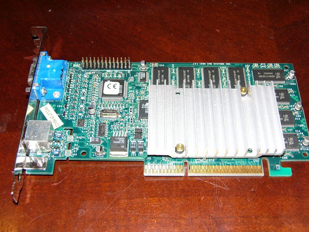

Here are photos of my two V3 AGPs, just for kicks.
Doesn't work in SE440BX-2
Does work in SE440BX-2

I was booting up both cards in the OEM system to check the BIOS when I solved the mystery.
The problem card caused a beep in the OEM system this time. I swapped it with the good card, which booted up right away. I waited a bit, then swapped in the bad card. That's when I saw this following an artifacted Windows 98 splash screen:
The V3 was dying. A shame.
