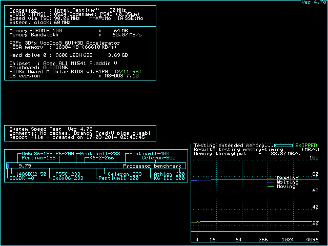

Reply 13 of 21, by gerwin
Attached the slowest speedsys core I could get out of the P54C on a Super Socket 7 mainboard: 9,79 points. I used Setmul to disable branch prediction and the V-Pipeline. As well as Caches of course. (This cannot be done a Pentium MMX, original Pentium only)
The second place went to the Cyrix 6x86L, using a 1.0x multiplier / 60MHz / no caches: 10,84 points in Speedsys.
On a 486 some games run to fast, Deathtrack for example. That can be solved by installing a 33MHz CPU model or running a Cx586 at 33MHz (1x) combined with using the De-Turbo function or disabling of the cache.
Reply 14 of 21, by alexanrs
What makes me think the 486 can go where no Petium can is this thread, where the OP mnaged to slow down his 486 DX2-66 down to a 3.04 score in SpeedSys. The branch prediction thing, though, is new to me. Did not know that it could be disabled... Btw, why were you using it with a 60MHz bus instead of 50MHz?
Reply 15 of 21, by gerwin
alexanrs wrote:
What makes me think the 486 can go where no Pentium can is this thread, where the OP mnaged to slow down his 486 DX2-66 down to a 3.04 score in SpeedSys.
Yeah that is pretty neat. But on some 486's De-turbo is the same as disabling internal cache, and in that case these options cannot be combined.
It was done on a Super Socket 7 ATX mainboard, and as is typical with these late generation socket 7 boards; 60MHz is the mininum FSB speed.
I don't think branch prediction makes that much of a difference for very old games. But it slows a little extra. 😀
