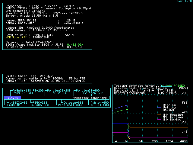

When the 50MHz FSB option (available on a few i440BX motherboards) is combined with the unlocked multiplier of an early deschutes Pentium II, you can get as slow as this:
The attachment P2_100MH.gif is no longer available
That is 100MHz, not 633MHz as diagnosed top left. The L2 cache dropped out for some reason.
Combined with an earlier Klamath core Pentium II: Same thing, but then L2 cache can remain functional.
A VIA C3 Nehemiah can also be installed on a i440BX with the right slotket. It maxes out at 1400MHz which is comparable to a Pentium III 700MHz, but with the benefit of a software adjustable multiplier for speeds below that.
Edit / Note: The SE440BX-2 probably won't cooperate with any of this. It has no jumpers and a restricted BIOS.
