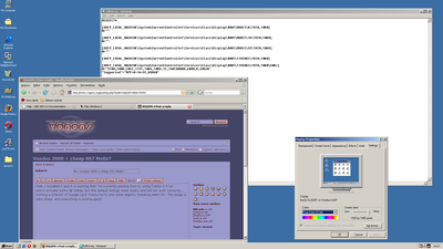

Reply 3 of 6, by alexanrs
Well, I installed it and it is working fine! I'm currently posting from it, using Firefox 2.0 \o/
And it actually works @ 1080p, but the default timings were wonky and did not work correctly... nothing a little bit of Google (and ToastyTech) and some registry tweaking didn't fix. The image is very sharp, and everything is looking good!
