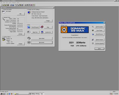

So it's the first time trying to run some direct3D stuff on my K6-3 rig, and to my surprise, all D3D apps I try to run on it freeze or reboot the system... Its a 1.6v K6-3 running at 550MHz (tried lowering frequency, same thing, besides, glide and openGL games run fine) on a Via MVP3 board, 256MB SDRAM and a Creative Voodoo Banshee AGP...
Like I said, all openGL and glide games run just fine, but Dungeon Keeper 2 reboots the computer, 3DMark99 freezes after a couple of seconds, Unreal does the same in direct3d mode, and even dxdiag tests freeze after 10-15 seconds or so... Tried latest 3Dfx drivers and some 3rd party stuff - same results... any ideas? I have directX 7.0a installed and I'm running windows 98 SE.

EDITED - finished reinstalling windows (clean) - installed latest reference driver - no direct 3d ("No hardware acceleration available") WHAT THE ACTUAL F*CK? I played Direct3D Homeworld and NFS Porsche on this thing a couple of months ago!!!!
EDIT2 - Ok, making progress! I installed reference driver 1.0 (first 3DFX banshee driver) and I have direct 3d now. Problem is, 1st driver doesn't have opengl.
EDIT3 - SUCCESS! I installed the latest 3D Blaster Banshee driver off Creative's website (they still have it 😁 ) and direct3D, openGL and glide all work perfectly.
t;l dr - the problem was the driver - installing the latest driver off the manufacturer's website fixed the issue. Stay away from the latest 3DFX driver for the banshee.
