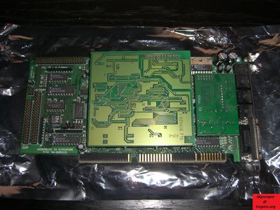

This daughter board will hardly fit on any other card so it stays on the AudioWave Platinum 16, I do move the whole sound card from system to system though. 😀
Here is an old picture I posted in another thread 2 years ago, it hides all its secrets though.
705.45 KiB
2438 views
