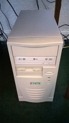

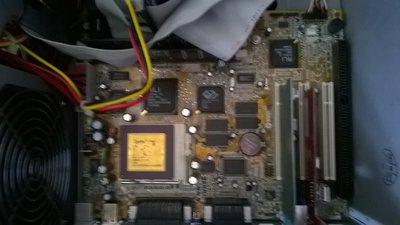

Reply 11 of 32, by BSA Starfire
feipoa wrote:
ibm5155 wrote:
The software that I'm running is InterVideo WinDVD 1.3.5c2
it's kinda of hard to find 🙁 ...
and if that's a super socket 7 system, maybe only using 64mb or 128mb of ram will speed things even more than 512mb (cacheable área, it depends of your chipset and cache)
If my research is correct, the ALi Aladdin V will cache up to 512 MB if you have 512 KB cache.
BSA Starfire, curious what your main use of this system is for? I don't hear of many people setting up a system based on the Cyrix MII.
1.49 MiB
992 views
1.43 MiB
992 views
Thanks for the replies everyone! So realistically I need a hardware DVD decoding card it seems.
In answer to feiopa's question, the system is an OEM Time computers system from late 1998/ early 1999.They were VERY common here in the UK at the Time with retails shops in most high streets. Apart from the upgraded memory and swapped out optical drive it is as originally shipped. I've always had a soft spot and interest in the Cyrix 6x86 cpu's along with the other more unusual chips of the period. Been playing through Sub Culture on it recently.I also own and use a DOS based system fitted with a IDT Winchip C6 200mhz(have also used AMD K6 166 & Cyrix 6x86 MX200 in that one too). Not being a QUAKE fan makes it easy to enjoy these non intel CPU's just fine, the slower FPU is no real hinderance & I just like the fact they are different.
