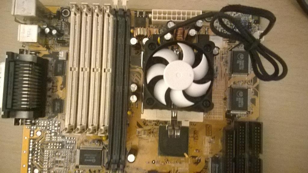

yesterday i set myself to recap my ASUS TX97-XE. It went fine i replaced all VRM caps, some of which were bulged. It was tough to get the old solder to get out but finally i was able to finish the job.
So when i power it on i got repeated beeps in an endless loop. This indicates a RAM issue. Hmmm again? Several weeks ago i had to order DIMM sticks because the exact same had happened. But as soon as i got replacements, i put one in and the system worked normally again.
This time i tried all the sticks i have and still the endless loop kept on going. So i tried clearing the CMOS and the strangest thing happened, the motherboard is now apparently stuck in sleep mode. The power light is blinking constantly, the system does not respond to the power button anymore so i have to reach and turn the machine on the PSU button. I also had the idea of trying the SIMM slots instead of DIMM, but to be honest i don't think it matters anymore.
My guess is that i have now a corrupted BIOS. I even tried a different CPU and nothing. The CPU's don't even get warm. 😵
I must have done something wrong during the recap, i'm thinking of ESD although i'm always careful when messing around with boards.
EDIT: Actually i tried touching the CPU removing the fan and it is a little warm, probably around 30ºC but still...

As far as caps polarity i know i installed them correctly as pictures i can see online confirm it. I checked if i hadn't shorted anything accidently in the back and looking really closely it doesn't look that i have.
I'm wondering if i ESD'd the BIOS chip.

I rather follow how the caps were installed before the recap.
Take a look into this picture, motherboard is the same model as mine:
My caps are installed the exact same way. And yes i actually reheated the solder joints a few hours ago and that didn't solve the problem.
This is mine. You can see that caps are oriented the same way:

All the solder pads were intact, in fact soldering the new caps was quite a breeze and the solder joints were good thanks to the EDSYN flux i use. So i don't know what went wrong.
When i first powered the board on after the recapping i got continuos beeping, which in an Award BIOS indicates bad RAM. After trying all the DIMM sticks i had here the board stopped beeping and the power LED flashes like it is stuck in sleep mode. It does not beep anymore. I think the BIOS is as good as dead.
I'm gonna try a couple of things. Try SIMM memory, and flash a new BIOS. If it doesn't work, i'll have to get another board.

I was felling super bored today, so i took the motherboard out of the case again and reheat some of the solder joints. I actually made a few solder joints to look worse...
I put it back in the case and...beep!! WTF?? I couldn't believe the damn thing was posting! So i plug the monitor in and keyboard and i actuallly booted it again. So i enter the BIOS settings to set values correctly and after a couple of minutes of setting BIOS the motherboard shuts off and power LED light starts blinking. Sleep mode again!
I'm sure now that the board is still repairable but needs recapping again. I'm wondering if i made the right decision choosing the caps. The original caps were rated 6.3V 1000uf and the Panasonic FM's i put in are 10V 1000uf. I'm wondering if this is affecting stability in any way.
This job is better done with the right tools. I do have a soldering station, but not a desoldering station. So at this point i think i'm gonna try to find a replacement motherboard but i'll also try to find someone with the right tools to recap the board again. I'm now very confident that if properly done the board will be up and running again.
Reply 11 of 17, by TELVM
That's great news, she's not refusing, she just wants a bit of foreplay. 🤣
If it booted up albeit briefly after retouching the joints, that sounds like some soldering-related gremlin.
... I'm wondering if i made the right decision choosing the caps. The original caps were rated 6.3V 1000uf and the Panasonic FM's i put in are 10V 1000uf. I'm wondering if this is affecting stability in any way ..
Nope, if anything higher voltage rating (all else being equal) would make it more stable, I wouldn't lose sleep on this. What brand and series were the original caps?

Reply 14 of 17, by Logistics
Son of a... I just recapped an M2N78-LA from an OEM system for my Paps, and couldn't get it to boot for the life of me. After inspection I realized that the polarity of all the factory caps was opposite of how I recapped the board. It is also an ASUS manufactured board. Why did they do such a horrible thing?!?!?! I have to start all over, now.

Reply 17 of 17, by TELVM
carlostex wrote:
... the original caps on my board were I.Q. branded 1000uF 6.3V
I.Q. is/was an OST brand, much closer in quality to Fuhjyyus than to Panasonics, so to speak. They have been succesfully replaced with very low ESR caps like Rubycon MBZ on mobos coetaneous of yours, so your choice of replacement caps is not the problem here, the mobo should work OK with the new Panasonics.
