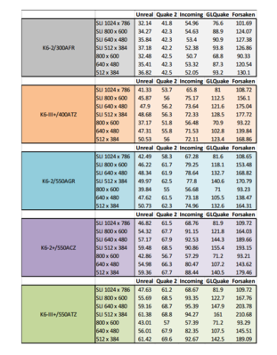

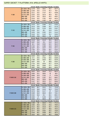

Reply 12 of 25, by PhilsComputerLab
In my "4 in 1 retro gaming PC" project, I used the GA-5AX and AGP V3 and also noticed that it was slower than using another motherboard. I thought that it's to do with that specific motherboard, but maybe there is more to it.
I've got some data from my Voodoo 2 SLI scaling project. I used a DFI K6XV3+/66 with VIA chipset: http://www.philscomputerlab.com/uploads/3/7/2 … ing_project.pdf
So you reckon VIA chipset is the way to go?
Attached the Socket 7 and Super Socket 7 results:

Reply 13 of 25, by F2bnp
I don't know 🙁. I have a few benchmarks on record that seem to be fine for Voodoo3, perhaps you could set up an MVP3 system with a Voodoo3 and K6-III+ 550 and post some results?
Unreal, Quake 2, Incoming and Forsaken are pretty good picks for benchmarking. If I had to add a few more, I'd go with Quake 3 (patch 1.16n), Descent 3, Shogo, MDK2, maybe even Dethkarz and Turok 2? I believe all of these offer internal benchmarks. I'll open up a new thread about this with more details!
