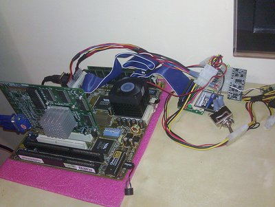

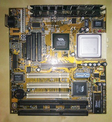

Hello,
i have a DFI P5Bv3+/e rev C board with Via 598MVP chipset. I'm using it with K6-2 533 mhz (@ 500 mhz and also underclocked (fsb 66) at 333 mhz). I'm currently using DIY ATX-AT adapter with PicoPSU, before that I tried also standard AT power supply. I used it with PCI TNT2, AGP GF3 and AGP GF4 MX4000.

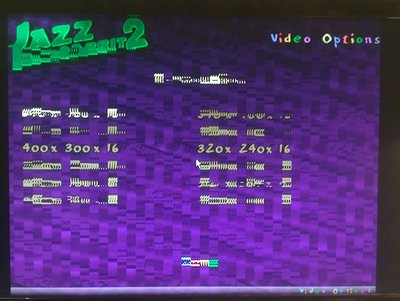

Jazz Jackrabbit 2 has corrupted and scrambled image. Sometimes it looks worse.

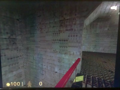

Then I tried Half-Life in Opengl and DX mode, it seems to look okay, but you can notice here weird pattern on the bricks texture - i don't think it should looke like that. Anyway it freezes after couple of minutes, or immediately after I turn the flashlight on.

All right, I had some problems, but now everything is almost OK. After I had success with Omega drivers I installed K6-2 533 CPU again. And screen was distorted, like it was before. So i tried K6-2 500 and almost all of distortion was gone, but there was still some. Then I tried K6-2 350 and everything was working fine, just like with the K6-2 300...
I looked into the manual, and there was a table with jumper settings for the CPUs. Fastest processors were K6-2 450 and K6-III 400. I did some research, and it looks like K6's faster than 300 MHz have Chomper Extended (CXT) core, which has some different features. I think that this motherboard couldn't recognize properly 500 and 533 processors and it may have treated them like overclocked K6s with regular Chomper core, and it caused problems.
I upgraded the 300 to 350 with CXT core and it works perfectly fine, because it has official support. Well, i think I should buy K6-2 450 then, it should be compatible and it only costs peanuts. I could also look for the BIOS update, but it already has a date of 01/03/2000, so maybe it was never intended to support these CPUs.
