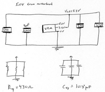

Reply 2 of 89, by feipoa
Attached is an image of how the POD's VRM is connected. Perhaps you could explain what you did in terms of this diagram?

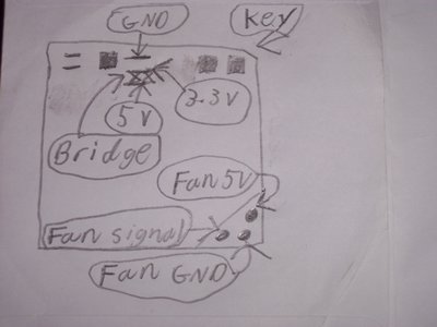

Reply 3 of 89, by stuvize
Sorry for the poor description I was trying to condense the subject, as for the voltage regulator the pin closest to the edge of the cpu is the ground the center is the 3.3 V and the next is the 5 V in. I found this info from someone else who found it buried on Nikos website, the 5 V in must be soldered to the 3.3 V pin or at least were it was I removed the voltage regulator from the cpu and bridged these two points with solder. I am not a expert on circuitry so some of this is over my head. What I meant by the fan was that it must be powered externally and the ground and 5 V pin that powered it from the cpu must be removed or insulated otherwise when the fan is powered externally the 5 V will backfeed into the 3.3 V circuit, the signal pin from the fan to the cpu must be left. I ran cpu check sadly it is running in write through mode but it still runs circles around the 100mhz ibm 586 I had even when it was running 40/120mhz and features turned on and it would crash eventually at 40mhz bus from games like quake or doom, I have never had the POD crash or freeze at 40/100mhz. I could not get 50mhz bus out of the POD even at 5 V with multiplier of 1 (fan removed) but I did not know that it was running in write through as it was so much faster than AM or CX 586 this may be linked to m919 issue with POD as I have read other posts with people running POD on via chipsets at 60/60mhz or even 66/66mhz. I hope my crude drawing helps clear things up too. what commands are used to get quake show fps in console?

OK. This is very simple.
1) short the 5V and 3.3V pins on the POD's voltage regulator
2) insulate the fan's 5V pin from making contact with the gold pad (heatsink side), for example, with a piece of electrical tape.
3) run a 5V wire from the PSU to the fan's 5V connector, perhaps by soldering it on
Any reason you removed the voltage regulator IC? Will it work with the VRM in place? Does leaving the VRM in place, with input/output shorted cause much voltage drop? Perhaps it is sufficient to snip these 2 leads.

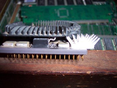

Modified another POD did this one without removing the VRM, got the solder hot and bent the VRM pins up and bridged the circuit. I uploaded a pic of cpu and also a pic showing how the fan is externally powered. Oddly this cpu is a little faster cpu when overclocked cpu check says it runs at 101.5mhz and the other ran at 100.1mhz Quake score was also a little better 23.1fps vs. 22.4fps. This CPU also doesn't immediately freeze at 50mhz bus. feipoa what mobo are you testing your POD in? I wonder what the best mobo for the POD is?

    Fan powered by mobo fan header

Reply 13 of 89, by feipoa
What is that aluminum coloured heatsink on the POD for?
In my opinion, the Biostar MB-8433UUD is the best motherboard for the POD. It works with L1 write-back cache and is very stable. I've tested several different PCI-based socket 3 motherboards and most were pseudo stable, at best, with the POD.
