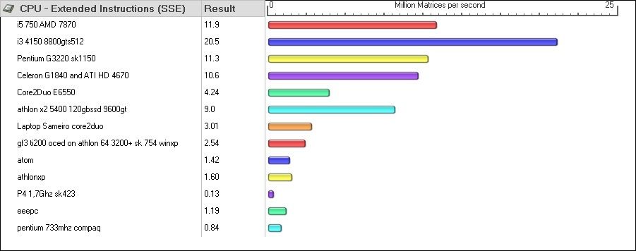

I've gathered a few results from a couples of machines and decided to compare them in PerformanceTest benchmark, and noticed that the Pentium 4 1.7Ghz has a ridiculous score when it comes to SSE instructions. Even the Pentium III 733Mhz wins by quite a margin.
I know that early Pentium 4, specially socket 423 were pretty bad when compared to Pentium 3 but this seems too much.
Is this a glitch or is this the expected result?

Looks like a glitch or defective CPU.
Even a 1,3Ghz P4 has faster SSE Score then a 733Mhz P3.

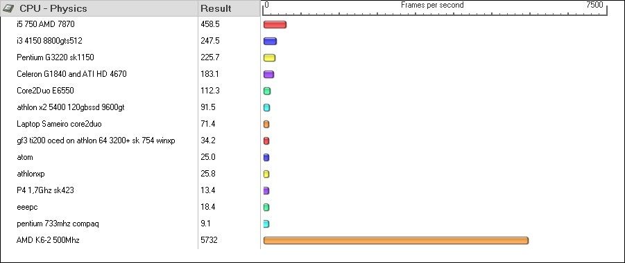

I really hope it's a glitch and not a defective cpu. PerformanceTest benchmark seems to be unreliable at times to be honest. I mean looks at this physics test:
My very first cpu AMD K6-2 beats the crap out of any cpu existing today when it comes to physics 😀
I should use some other benchmarking software i guess.

Indeed; also use other benchmarks. If you'd like you can compare with benchmarks I did here using a Pentium 4 'Willamette' 1.7GHz with single-channel DDR RAM. You can download most of my the benchmarks I used here.
If you still have unusual low results: check if your CPU is running at 1.7GHz (use CPU-Z) and look at the actual clockfrequency. The CPU namestring will always say 'Intel(tm) Pentium(tm) 4 1.7GHz' or like that regardless the actual clockfrequency. Also check RAM settings and verify that the cooling is sufficient. If the cooler is mounted incorrectly the CPU will overheat which causes the Thermal Throttling to kick in. This mechanism protects the CPU from burning and will let you continue using your PC; but at a very slow speed 😉. Search on the 'net for the application 'Throttle Watch' to monitor wheter your CPU is throttling or not.

Well, this test is the only odd test of all tests i've done on this machine. Even all other cpu tests on PerformanceTest benchmark this Pentium 4 scores way higher than the Pentium 3 733Mhz, so i figure this is only a glitch. Oh and CPU-Z also shows everything as it should be if i remember correctly.
