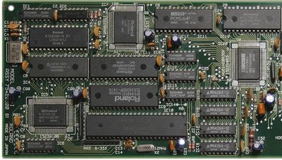

Reply 5 of 23, by Great Hierophant
One issue with putting the MT-32 in a Waveblaster form factor is that the MT-32 circuitry takes up a lot of PCB real estate. If you take the LAPC-I, you can obtain most of the essential circuitry you would need for a Waveblaster card by cutting it down the middle between IC19 and IC22. The result is still long and rather heavy by Waveblaster standards. I think it may fall off some of the shorter cards with Waveblaster headers, and you can forget about using an MPU-401AT unless you find a way to support it.

Yeah, that's a good point, GH. And it highlights how such project could be undertaken.
A straight form-factor conversion would require a LOT of reverse engineering of the connections between IC's and the IC's themselves to see what real-estate is available and what opportunities could exist for replacement by newer, more tightly integrated (but functionally equivalent) components. I've tried to find a datasheet for the LA32 chip (either DIP or QFP versions), but I haven't found one in the public domain.

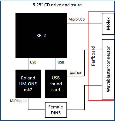

Reply 17 of 23, by alexanrs
This is an idea:
The attachment MUNT drive.png is no longer available
Get the enclosure from a busted CD/DVD drive, use some plastic/rubber/tape to isolate the inside, fixate the components (and zip-tie stuff like the UM-ONE), make a cable with a female DIN conector and use a perfboard (or etch a simple board) with a molex connector (for power - as I do not trust getting it from the sound card) and a waveblaster connector. Install MUNT, configure its ALSA server and aconnect to bridge the MIDI in to MUNT and have that start automatically. Then just run a flat cable from the drive to the sound card. Oh, and you might need to add a little buffer opamp for the line out, taking advantage of the waveblaster's 12V and -12V line and put a decoupling capacitor between the USB sound card's line out and the IC. Oh, and using an optocoupler between the header's MIDI pin and the UM-ONE's MIDI input is probably needed as well.
