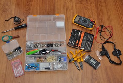

Reply 5 of 12, by brostenen
JayCeeBee64 wrote:
...bag of spares...
Might find this solution usefull then 😉
It's my box of screws and small parts. Love this kind of solution as it can be placed in a closet and have stuff thrown on top.

Reply 7 of 12, by brostenen
JayCeeBee64 wrote:
That box looks very useful indeed brostenen. I know two local hardware stores that have them in several sizes, will give them a visit when I have some free time 😊 . Thanks!
No problemo. Have had this for the last 10 years or more. 😀
