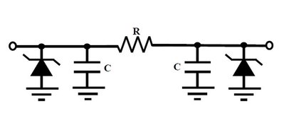

Reply 4 of 19, by PCBONEZ
These are all related.
PCBONEZ wrote:
Problem was found to be Asus not complying with Intel's recommendations in the chipset design guide..
xjas wrote:
Were you using the "floating" (un-grounded) case-front USB ports? I am aware of that problem.
TELVM wrote:
^ Same here, always run an earth wire to ground to chassis any 'floating on plastic' USB front ports.
Intel called for an EMI filter with ESD protection to be installed on the motherboard at the USB header or on USB near the chipset .
That is a small inexpensive circuit that only requires 5 or so SMD parts to pull off. (I will attach an example circuit though it's not specifically for USB.)
For a time motherboard manufacturers were 'cheaping-down' by not installing these parts.
[I pick on Asus for this because they didn't limit this 'cheaping down' to their low end models. Asus cheaped down their high end models this way too.]
Intel was not to happy about their chipsets being called defective when the real cause was cheap-skate implementations by mobo manufacturers but they beefed up the ESD protection internally in the chipsets anyway to cover their own arse. That helps but it's no where near as good as using discrete components.
In the example circuit the resistor may be an inductor instead. The caps are somewhere around 10pF (tiny SMD parts).
Then there is that case manufacturers cheap down on their front USB ports.
That ground wire you people (and I) add to those ports is actually required by the USB specification.
It should already be there.
If you have a cheaped down mobo -and- a case with a cheaped down USB ports there is a pretty good chance you'll kill the USB and/or your chipset.
While I'm on USB compliance.....
(You will see A LOT of misinformation about this one.)
I've come across a lot of USB gadgets that plug into USB headers that skimp and only use 8 pins.
That was 'legal' for USB1.x but to be truly compliant with USB2.x the 9th pin is required. It's not optional.
USB cables that are truly USB2.x compliant have a shield and a shield drain wire. The 9th pin is to properly ground the shield.
I've seen a lot of people blow out their USB ports by overloading them - usually with 2.5" SATA drive gadgets or chargers.
USB1.x and 2.x ports have a current limit of 500 mA (1/2 amp). - That's the 'official' number.
People got the idea with older 2.5" IDE drives that one port was enough for an external USB HDD but very few 2.5" Sata drives (or larger IDE drives) use less than 500 mA.
Yes - For USB powered USB HDDs you need one of those cables that uses two USB ports to not overload your ports.
For chargers - the people that build and sell these don't seem to know what a current limit is. Check the specs before you use one.

Reply 7 of 19, by PCBONEZ
If you look at a properly done case front USB port there is more than just a ground.
There will be some small SMD parts. That's an example of one of the filters I've been talking about.
