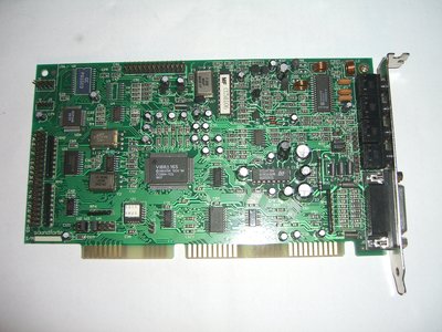

I just got a interesting Media Forte Vibra 16 card in a lot of cards I bought. Its a Soundforte 16 FMP-03 with a DXP44Q FM synth and Im wondering if anyone knows anything about this chip.

My thinking is that if the DXP44Q isnt a rather good OPL3 clone or even a bootlog OPL3 then why diddnt the card maker use the CQM "FM synth" in the Vibra 16 chip?
Here is a picture showing the Soundforte 16 FMP-03 with a DXP44Q FM synth and also a built in radio tuner.

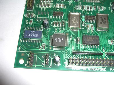

Here is a close up of the DXP44Q and the area around it.

Any information about the Soundforte 16 FMP-03, the DXP44Q chip or other sound cards that use it would be great!
Im also interested in the drivers for the card (I have the radiator.zip file from "driverguide.com" already).

I installed the card in the IBM Aptiva 2144-900 "TYPE C-1" 486 DX2-50 desktop carcass I recently bought for 10 euro and wired up a test drive.
The Soundforte 16 FMP-03 dosnt need any special drivers loaded in DOS, it works fine using only a SET BLASTER line and diagnose.exe /S. As far as I can tell the DXP44Q is a "real bootleg" OPL3 but I have only listened to the music in Tyrian so far and I use crappy speakers. The cards general sound output quality seems very good with very little noise, I disabled the onboard amp though.
