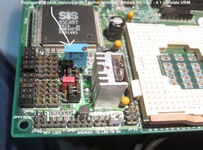

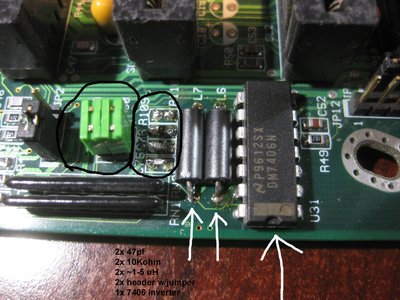

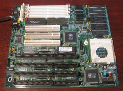

The Chaintech 486SPM, like the MSI MS-4144, has solder pads in place for native PS/2 mouse implementation. If you want to add PS/2 support to the Chaintech 486SPM, I've added some easy to follow images of which components need to be added on. I tested the mouse and it is working fine.
You can also add a coin cell CR2032 battery holdfer if you pull up D1, which would otherwise charge the battery.
If you want to add variable voltage support, replace the 909 ohm resistor with a 1 Kohm trimmer as shown. This will give you a variable 3.0 - 4.1 V to the CPU.
What's needed (for the PS/2 mouse addition):
2x 3-pin headers w/jumpers
3x 2-pin headers w/jumpers
1x 4-pin header w/PS2 mouse connector
2x inductors ~1-6 uH
2x SMD capacitors, 47 pF
2x SMD resistors, 10 Kohm
1x 7406 inverter IC
Use Modbin to add PS/2 support to your AWARD BIOS. Actually, I will just upload my modified BIOS here.

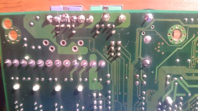

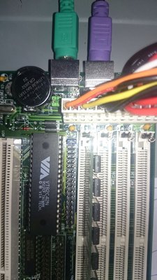

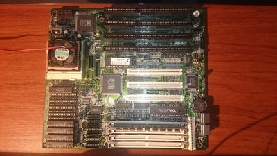

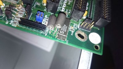

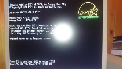

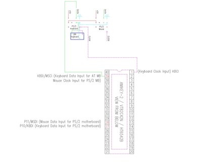

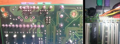

Hi. I own Chaintech 486SPM Rev. M103 with BIOS labelled 02/08/96. I made this mod with original PS/2 connectors and PS/2 mouse does not work. Keyboard works.
I "beeped" all the traces and I found out that all 4 lines of the PS/2 mouse spots are connected +5V/ground and data and clock to VT82C42N chip. See the schema. I soldered both headers, flashed the BIOS and placed the jumpers. It is my first job with soldering iron.
It looks like that the bios still does not support PS/2 mouse. Could you tell me please why the ps/2 mouse not work? Did I miss something? Is it possible that the BIOS was flashed badly?
Thank you.

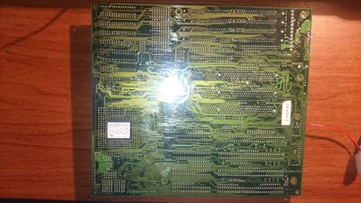

Reply 7 of 29, by feipoa
Provide high res. photo of top and bottom of entire motherboard after mod.
Reply 8 of 29, by Rabanik
I am not proud of my soldering job 😀

Reply 10 of 29, by Skyscraper
Rabanik wrote:
Here are the rest.
No disrespect but those pictures look like they have been taken with a potato! 😁
In this picture the soldering looks like a mess but from the picture you posted before it's possible to see that the soldering (of the ports at least) is totally fine although perhaps a bit messy. 😀
Perhaps they are good enough after all if feipoa only wants to check if any component is missing.
Reply 11 of 29, by feipoa
Rabanik, I recommend that you follow the tutorial. You are missing all the components I highlighted in the OP, e.g. 7406 inverter, inductors, resistors, capacitors, jumper headers, etc. This board contains the solder pads for these items, but you must source the items and solder them in. Is there any reason you did not solder in the missing components?
Reply 12 of 29, by Rabanik
I thought that the rest parts are required only for volt regulator. I dont have SMD capacitors 47 pF right now. It will take a few days. I let you now than. Thank you.
Reply 13 of 29, by feipoa
OK. I thought it was pretty explicit from the OP,
Looking forward to your success.

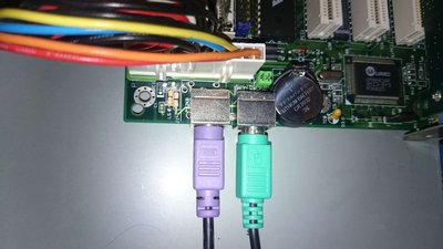

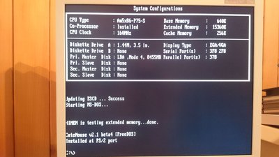

Reply 14 of 29, by Rabanik
Hi guys,
I soldered the rest of the parts and this mod works. I must only replace both big inductors for the smaller ones. But I ordered them. Thank you Feipoa!
