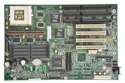

Reply 6 of 12, by Malvineous
Yep it's the same connector used on a 3-pin fan (that's what I meant by "3-pin connector, same style as a fan connector" in my first post.)
I've attached a photo of the board. Not sure of the AA number, perhaps you can spot it? There is a "CA" number, I'm not sure if that's it.
BIOS string is just AMIBIOS BIOS Version 1.00.06.CB0 - there's no other identifying information shown.
    1.56 MiB
    615 views
    Motherboard photo

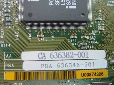

That's it. Here is a screen shot of a different example of the same board where the stickers were placed better.
You can see the AA on the board's silkscreening.
169.29 KiB
590 views
(As I understand it.)
The AA number gives the basic part number and minor revision.
The PBA number shows any major revisions or customizations for OEMs (Like Dell/HP/Gateway).
The "CB0" gives away the model. -- It's an Intel Advanced/EV (aka Intel Endeavour)
http://www.elhvb.com/mobokive/Archive/Intel/A … EV_28183501.pdf
http://www.elhvb.com/mobokive/Archive/Intel/A … pd_28182506.pdf
In the first PDF see page 25 about the power connectors and soft-off.
Also see page 17 about your keyboard port.
They came either way (AT or PS/2 style) which is why your board doesn't exactly match some photos of this model you see online.
