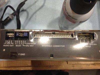

So, closer inspection revealed the cable to have following pins, left to right, eject thingie up:
red yellow black white
The Pioneer (original) CD ROM reads:
R G G L
So I guess, if yellow and black are both ground, then the pinout is correct from CD ROM's point of view.
The sound card does not have a pin layout written, but it says SONY/IDE next to the compatible cable jack, and PANASONIC next to an incompatible one.
Here's what I found what I tried to google "sony ide pins"
494.58 KiB
572 views
So, looks like the same pinout as Pioneer, only upside down (looks like eject thingie should be placed downwards in Sony and upwards in Pioneer). So it should work, but it doesn't. What am I missing?

Just thinking about it, if the pinouts were wrong, you'd have one of three problems:
  • RGGL -> RGLG = right audio, left muted
  • RGGL -> GRGL = left audio, right muted
  • RGGL -> LGGR = left and right swapped
So no matter what CD cable you use, you should always hear at least one channel of CD audio.
Since you get no audio with either CD drive, it must be the sound card input not passing along the signal for some reason?

So, turned out it was a driver issue, after all. Win 98SE comes with some sort of basic drivers for this card, which is why I didn't bother to look for them. However, once I've installed the correct drivers (95/98 version, not 98/2K/NT), everything worked fine.
Thanks!
