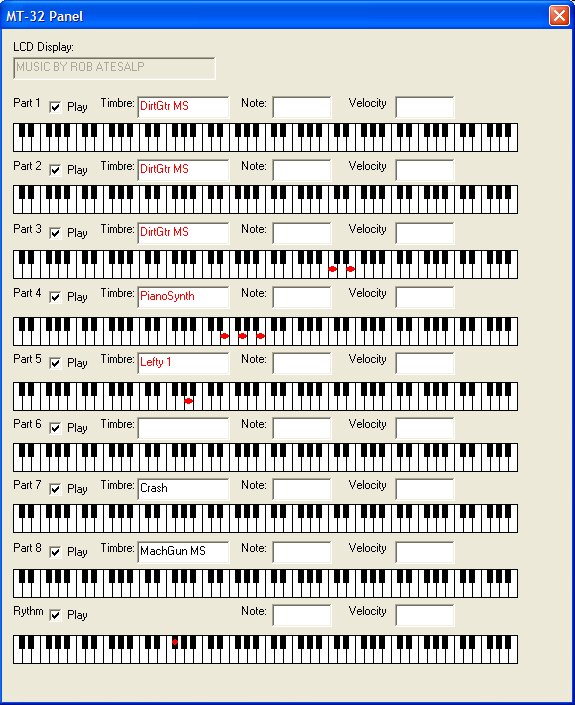

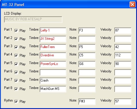

Reply 6 of 18, by Ictoagh
Just a quick shot of my "debug panel" for the Win32 Doxbox version...
Right now, I have no means of displaying multiple notes at once, so the note display is sometimes (usually) incorrect 😉
Other than that, it has the LCD display, Channels can be kicked on/off. Eventually I want to add a patch browser, as well. And display the partial count, Mod, Pitch, Volume, Partail Reserve. (maybe scale down the font, to keep things small... it's a lot of information....)
It doesn't appear to lag the system much, either.... but, then it's hard to tell on a 2+GHZ computer ....
Would anyone like this included? Let me know what you think!
Reply 7 of 18, by canadacow
Wow... that looks great. I'm trying to patch up these last few problems with the sound before I personally make any DosBox external release. Its just easier to test game output from there. I know Nemesis has completed library for the MT32 which I plan to use to make a portable Linux/Win32 driver in the near future, and I think a control panel like yours would go along with it quite well.
In other news, I took another stab at the filter tonight... its still not perfect, but it keeps getting closer and closer. I might have a new version ready by the end of the week!

Reply 10 of 18, by Ictoagh
Here's a new shot of the panel, now with keyboards representing the notes.I need to rearrange things a bit to more efficiently use screen real-estate... It takes up a considerable amount of room, but it's kinda neat to watch 😉
Reply 11 of 18, by vladr
How about color-coding? One color per channel, and one keyboard with multi-colored bullets? 😁
